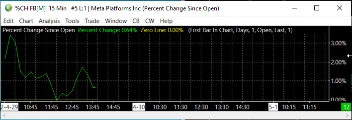

Is it possible to have more than one line in the Percent change since open study? As it currently stands, I have the % change since open where Current price = Last, but I would also like to have two more line in the same chart region where Current price = High and Current price = Low.
Thank you,
Julien
imageSierraChart_64_a1CS9khKaJ.png / V - Attached On 2022-04-29 18:05:21 UTC - Size: 61.61 KB - 320 views
[2022-04-29 21:04:50]
John - SC Support - Posts: 48388
Just add the study 2 more times and change the Input Data for Current Price to what you want for each one. Refer to the information for this study here:
Percent Change Since Open
If you want to have the lines in the same region, then make sure the Region setting for each of the studies is set to the same region as the first one. Refer to the following:
Chart Studies: Settings and Inputs Tab >> Chart Region
