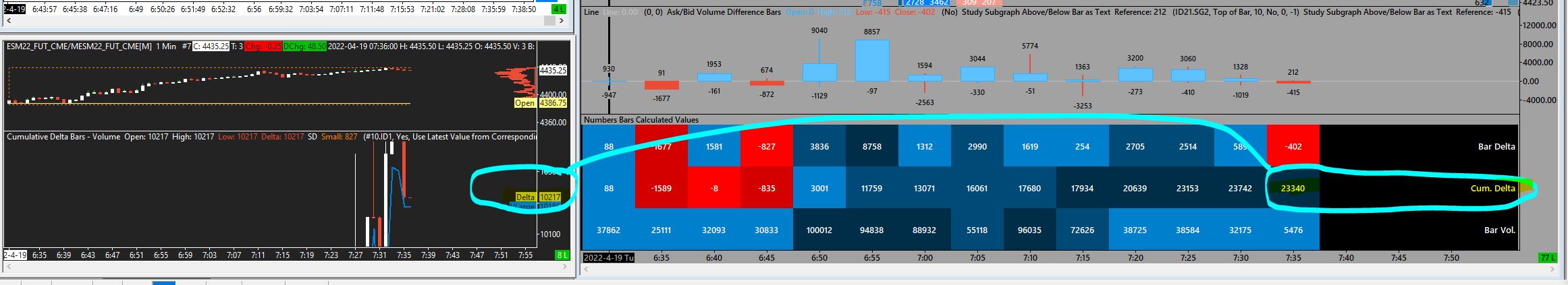

1) For example, My number bars chart w/ Number Bars Calculated Values study always has different values than a 1m candle chart with Cumulative Delta Bars study, see attached.

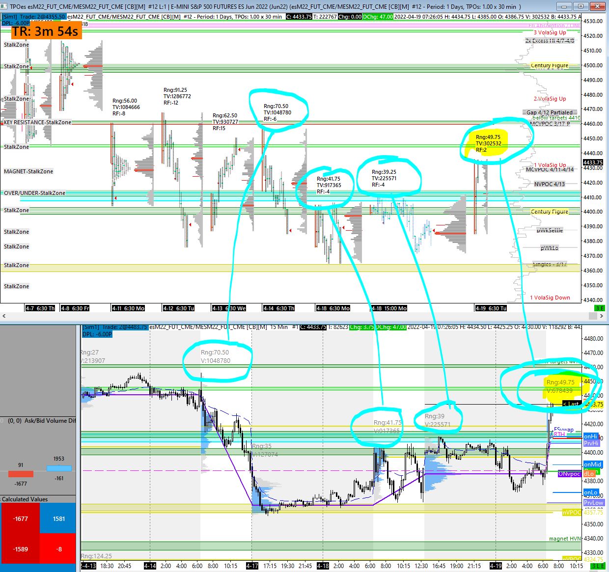

2) Also a 15m candle stick chart using a VbP study also has different intraday volume than a TPO chart. These two studies have aligned volume on all sessions except the current intraday session, see attached
Any idea why this happens? All session times are the same and all of these charts are intraday charts. I am not sure which of the values are the correct ones

I am comparing cumulative delta values between chart #7 (Delta), and chart #2 (5minFP-es)
I am comparing total volume between the RTH VPB on chart #1 (PNFes) and volume on RTH session of chart #12 (TPOes)

With regards to the delta values between charts 7 and 2, we do not see any difference. It's hard to see while the data is running, so the easiest thing to do is to select File >> Disconnect and the values at that point should be the same. We have done this and each time the values were exactly the same.
With regards to the Volumes, the Session Times are different, and the TPO chart is not using the Evening Session, whereas you do have this enabled on the VbP.

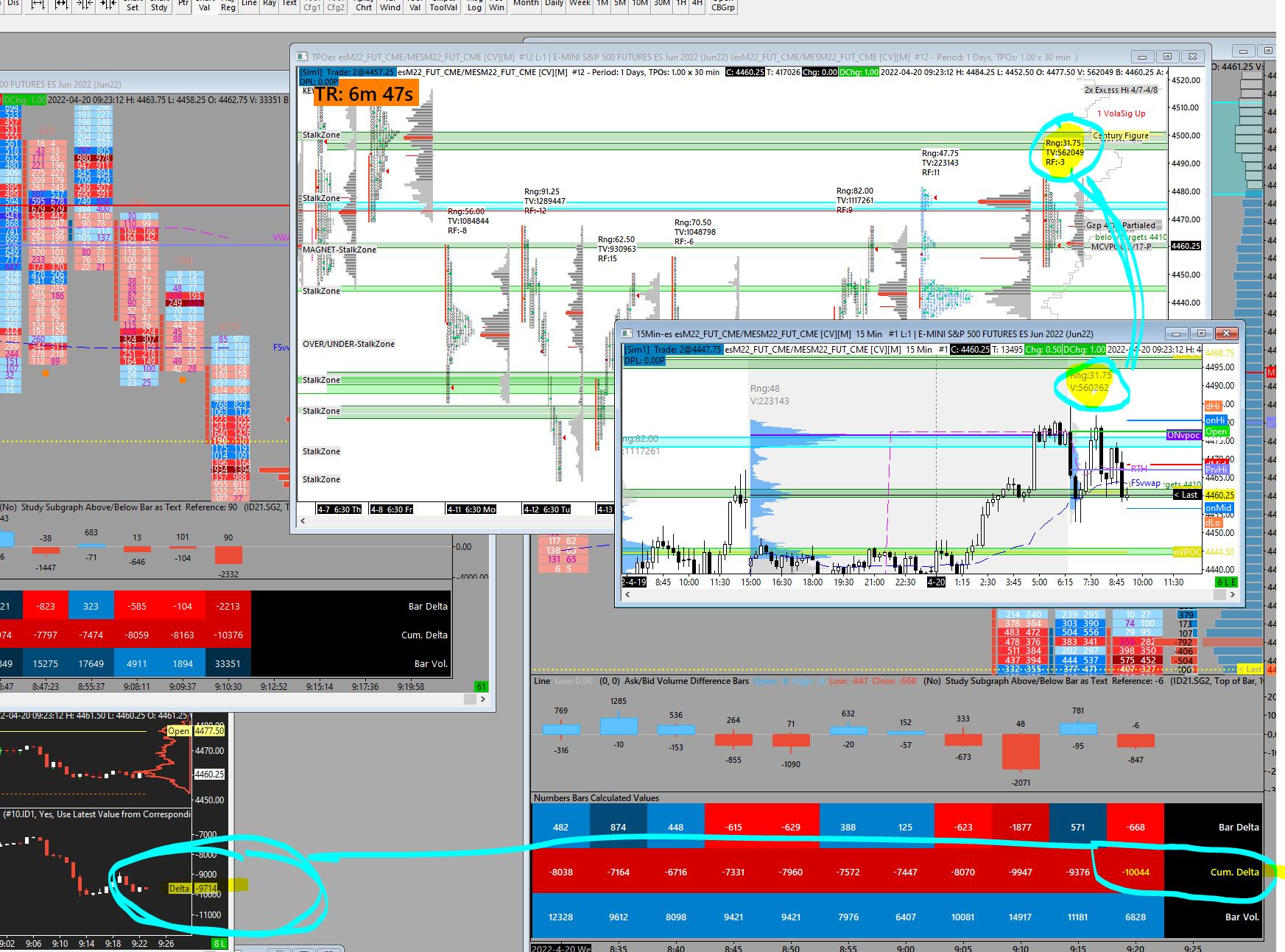

I went through every setting and found that certain settings were not lined up such as the Continuous contract type, Chart update in Milliseconds, Combine Trades into Original Summary
In regards to the volume on the two charts with different session times, I did manage to get them aligned by fixing the chart settings as well.
imageCapture.JPG / V - Attached On 2022-04-20 16:24:12 UTC - Size: 415.37 KB - 307 views
