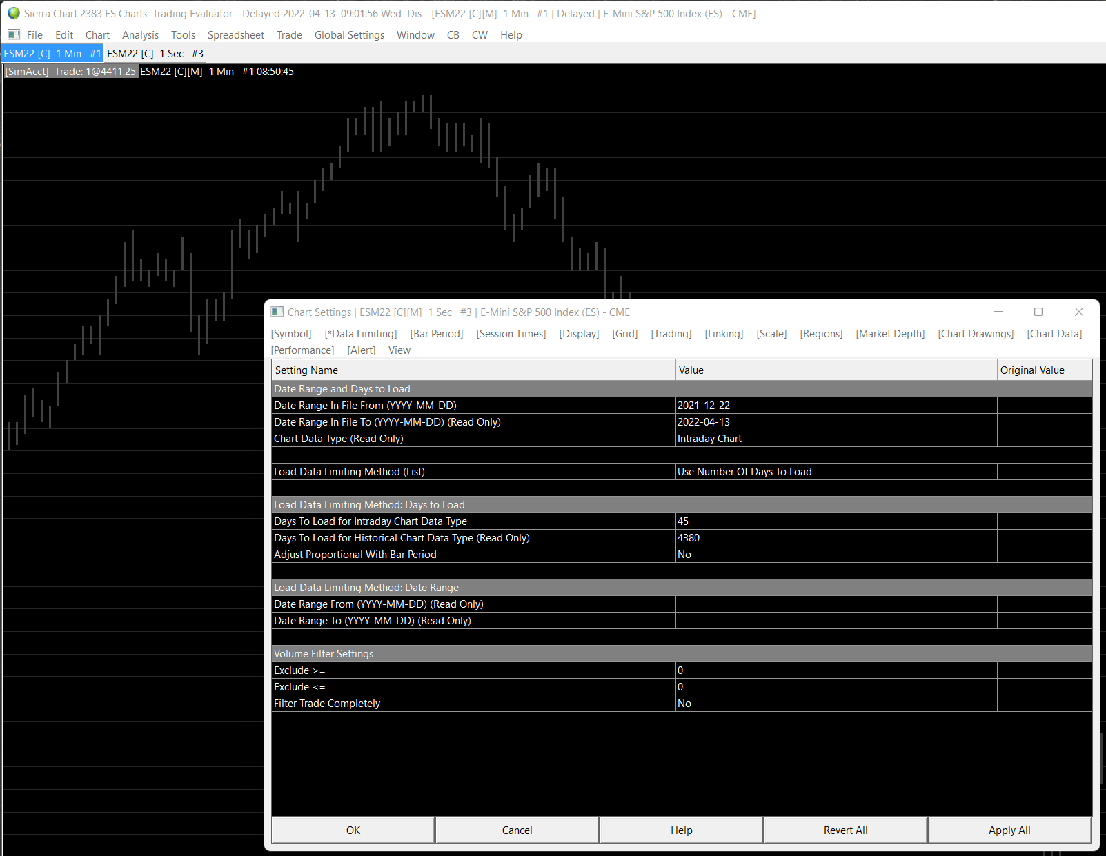

The DaysToLoad value passed to OpenChartOrGetChartReference() is not being correctly set.
In the example below, setting the value to 15 results in an actual value of 45.
Set the attached screenshot for the actual result of running this example.

imagedaystoload.png / V - Attached On 2022-04-13 14:05:13 UTC - Size: 82.73 KB - 264 views

As we suspected, the problem is not reproducible even when we have set a default number of Intraday Days to Load.
We have added this to the documentation:
When getting a reference to an existing chart, if the existing chart has a higher Days to Load setting, then that chart will be returned and that Days to Load setting for the existing chart will remain.

My study requires data at second granularity regardless of the granularity of the user's chart. In order to get second level data, my study creates a hidden chart that attempts to match the user's chart settings, including number of days to load. When the user changes their "days to load" to a smaller value (say from 45 to 15), I need to have the second data match. Do I just need to avoid trying to reuse the existing chart and recreate the chart each time to accomplish this?
[2022-05-08 17:15:51]
Sierra_Chart Engineering - Posts: 25326
We will implement a solution for this by adding a new variable to always use the exact number of days specified.

This has not yet been tested but we have added this variable which you can set to 1:
s_ACSOpenChartParameters::UseExactMatchForDaysToLoad
This is in the latest prerelease.
