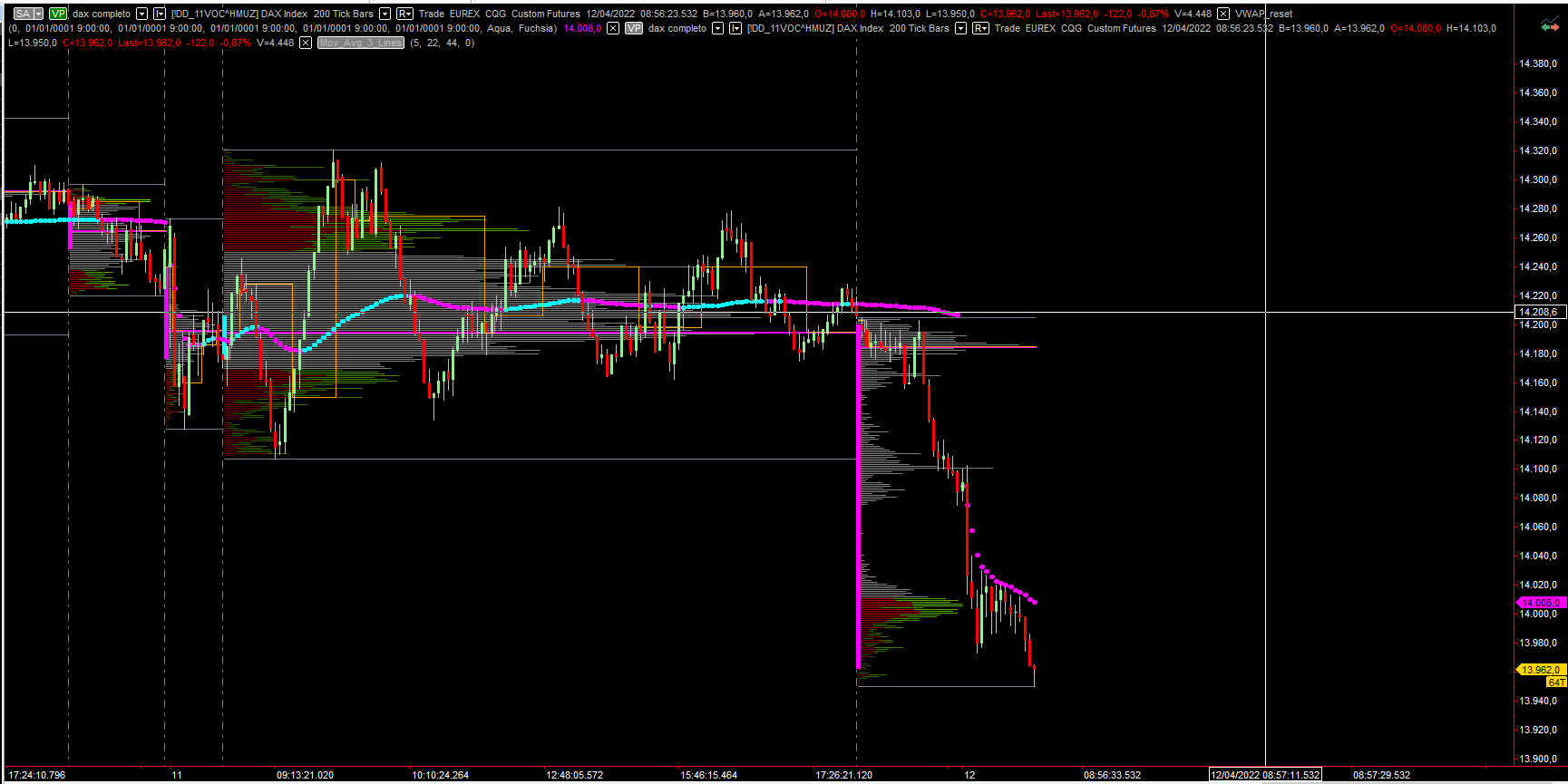

hi, I'm use tu use Multicharts and set my graphs on Tick count. For exemple attached the DAX view on 200 ticks per bar.
Can you help me to reproduce this? I tried with Number of trade per bar=200 but it doesnt give me the same look. Many ths

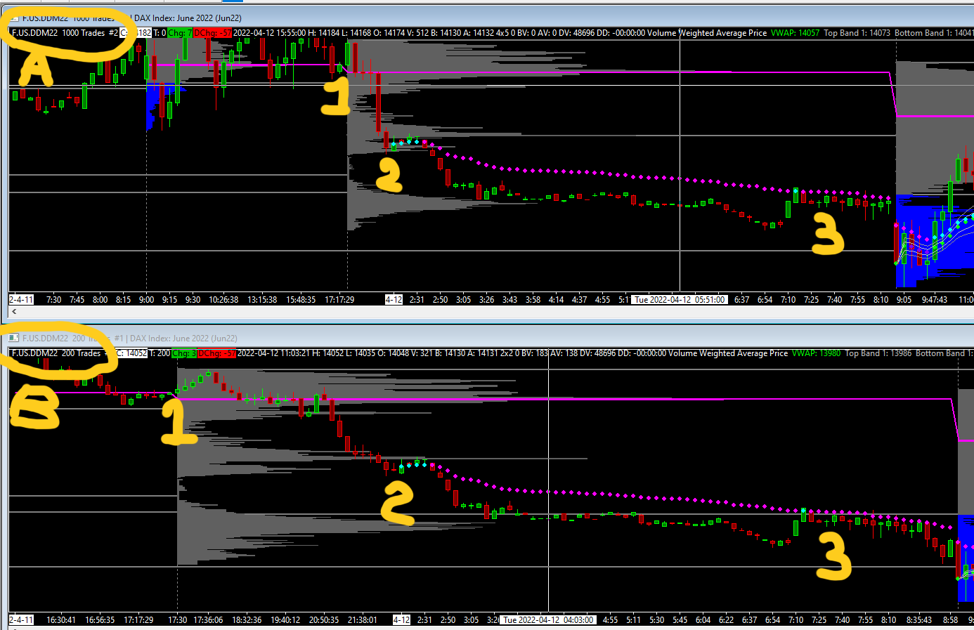

I attached a new screeshot.

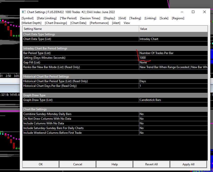

Is from DAx, the one above (A) set as 1000 ticks per bar, the one below (B), 200 ticks per bar.
As you can see from the point 1 to the point 2, the graph above has less bars, as it should be( more trades per bar, less bars). But from poit 2 to poit 3, the bars look the same to me and it doesn't make sense.
What do i do wrong?
imagedax tick 200-1000.png / V - Attached On 2022-04-12 15:33:57 UTC - Size: 82.99 KB - 358 views
imageset dax 1000.JPG / V - Attached On 2022-04-12 15:34:14 UTC - Size: 114.64 KB - 349 views
[2022-04-12 15:46:43]
John - SC Support - Posts: 48369
Use your Crosshair and the Tool Values Window to evaluate each bar and see if they have the correct number of trades per bar.

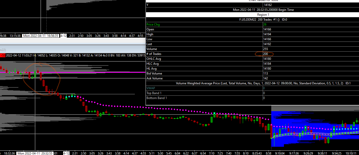

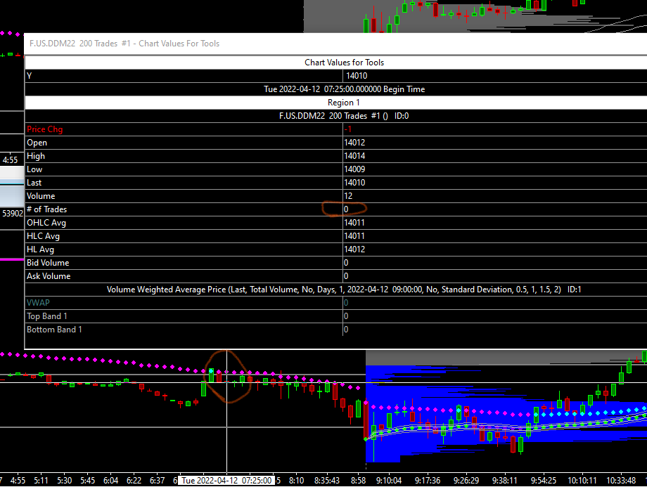

OK, as you can see, before point 2 and after poin 3 from the prewieus screenshot, the # of trades are correct (200 or 1000) and, in fact, the bars looks different one to the other.
In the middle from point 2 and 3, the # of trade is 0.
This is the issue. Haw can i fix it?
Many ths

[2022-04-12 17:07:23]
You are using CQG data and you must not have been connected to the data feed during that time, so it is filling in with historical data. But the historical data from CQG is in 1 minute increments and must not have the trades information in it. Refer to the second bullet point at the following link for more information on the CQG historical data:
https://www.sierrachart.com/index.php?page=doc/Whats_New.php#SCVer2351
The only solution would be to use our Denali Exchange Data Feed where the historical data is per tick and has all the Bid/Ask/Trade information. Refer to the following:
