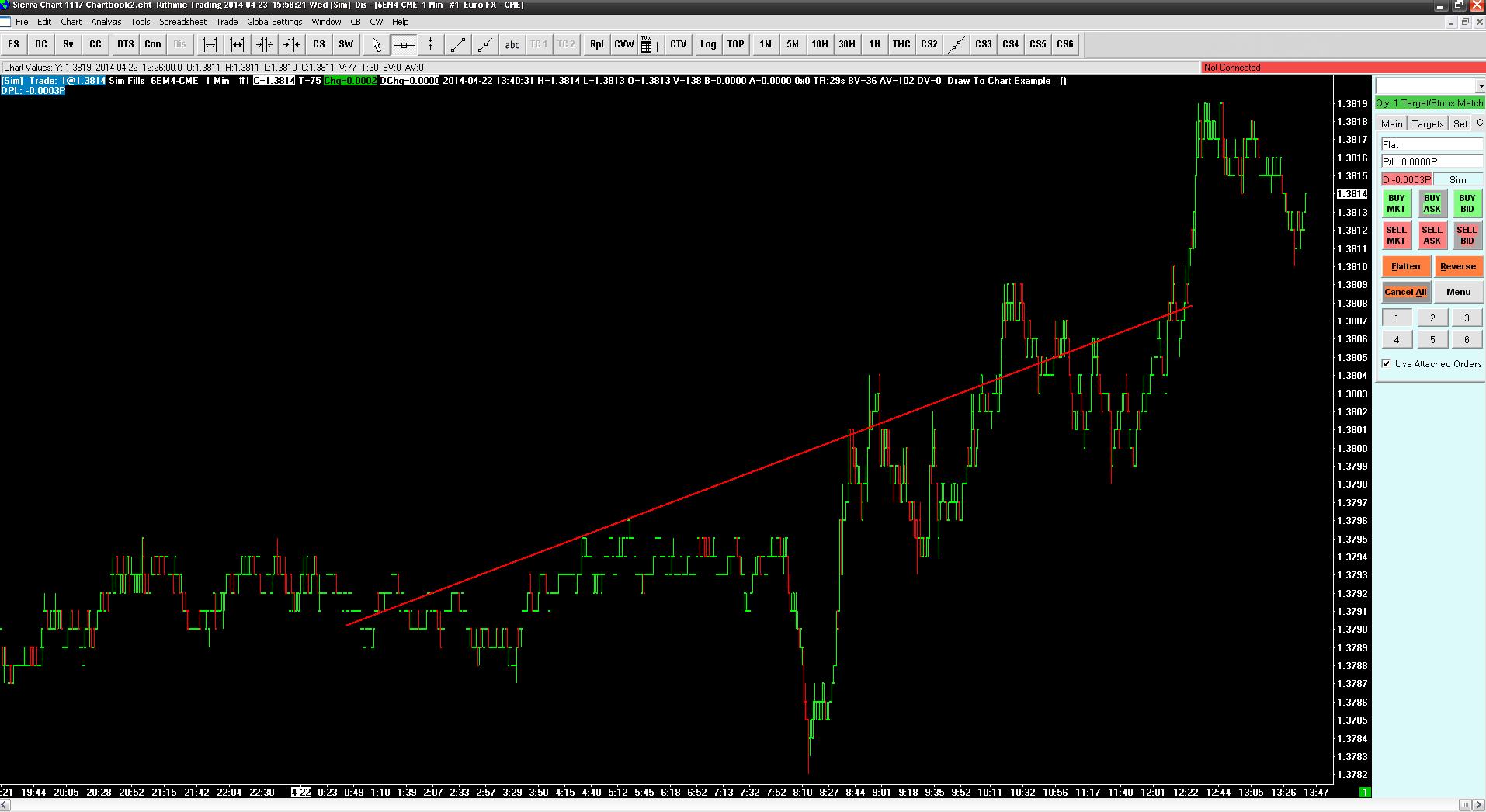

Dear SC Support,
I have a problem with drawing using sc.p_GDIFunction. Study is calculated only when it is applied on the chart or when I
press "Recalculate" at the chart menu. After I do some interactive action with chart, moving or scrolling, I see a wrong drawing result.
Code:
// GDI.cpp : Defines the exported functions for the DLL application.
#include "stdafx.h"
#include <windows.h>
#include "C:\SierraChart\ACS_Source\sierrachart.h"
SCDLLName ("GDI Example")
// This file demonstrates the functionality to use the Windows graphics device interface with ACSIL to freely draw inside of the chart window
// Windows GDI documentation can be found here: http://msdn.microsoft.com/en-nz/library/windows/desktop/dd145203%28v=vs.85%29.aspx
void DrawToChart(HWND hWnd, HDC hDC); //Drawing function declaration
int firstY;
int secondY;
int firstX;
int secondX ;
SCSFExport scsf_DrawToChartExample(SCStudyInterfaceRef sc)
  if (sc.SetDefaults)
    // Set the configuration and defaults
    sc.GraphName = "Draw To Chart Example";
    sc.AutoLoop = 0;
    // When specifying a GDI function below, this must be false. Otherwise, the GDI function will not be called.
    sc.FreeDLL = 0;
    sc.GraphRegion = 0;
    // This is how we specify the drawing function.
    sc.p_GDIFunction = DrawToChart;
    return;
  // Do data processing
firstY = sc.RegionValueToYPixelCoordinate(sc.Close[sc.ArraySize - 1],0);
secondY = sc.RegionValueToYPixelCoordinate(sc.Close[sc.ArraySize - 100],0);
firstX = sc.BarIndexToXPixelCoordinate(sc.ArraySize - 1);
secondX = sc.BarIndexToXPixelCoordinate(sc.ArraySize - 100);
//This is the actual drawing function. This function is specified by the "sc.p_GDIFunction" member in the main study function. This drawing function is called when Sierra Chart draws the study on the chart. This will only occur after there has been a call to the main "scsf_" study function which is defined above.
//Currently this drawing function does not have access to the ACSIL "sc." structure. We are considering how this might be possible to add in the future. Any study data that you need to access in this drawing function, should be placed into global variables by the main "scsf_" study function which can then be accessed by this function when it is called.
  // Создаем Pen
HPEN hPen = CreatePen (PS_SOLID, 2, RGB(255, 0, 0));
// Выбираем свой Pen в DC, запоминаем старый Pen
HPEN hOldPen = (HPEN)SelectObject (hDC, hPen);
// Перемещаем точку рисования в левый верхний угол окна
MoveToEx(hDC, firstX, firstY, NULL);
// Рисуем линию в правый нижний угол
LineTo(hDC, secondX, secondY);
// Выбираем старый Pen в DC (освобождаем свой Pen из DC)
SelectObject(hDC, hOldPen);
// Удаляем Pen
DeleteObject (hPen);
  return;
imageAfterApplyingStudy.jpg / V - Attached On 2014-04-23 14:00:37 UTC - Size: 169.98 KB - 831 views
imageAfterResizingBarSpacing.jpg / V - Attached On 2014-04-23 14:00:46 UTC - Size: 181.66 KB - 750 views
[2014-04-23 17:29:20]
Yes, this is true:
[2014-04-23 19:12:53]
ejtrader - Posts: 689
norvik - There are few limitations with GDI function at present. Main issue is lack of "SC" structure availability to this function ( which SC team is going to look at it at some point in the future ).
I started using this function but due to unavailability of SC structure - but ended up going with UseTool instead.
If it is a must for you to use GDI functions, you would have to depend on global variables a lot and keep populating them on every tick( to account for any changes to the SC window co-ordinates) and make a call to GDI function on every tick.
In general - It's really not convenient to use it in it's current state and you might want to use UseTool instead until SC structure is made available to GDI functions somehow(??).
Date Time Of Last Edit: 2014-04-23 19:14:37

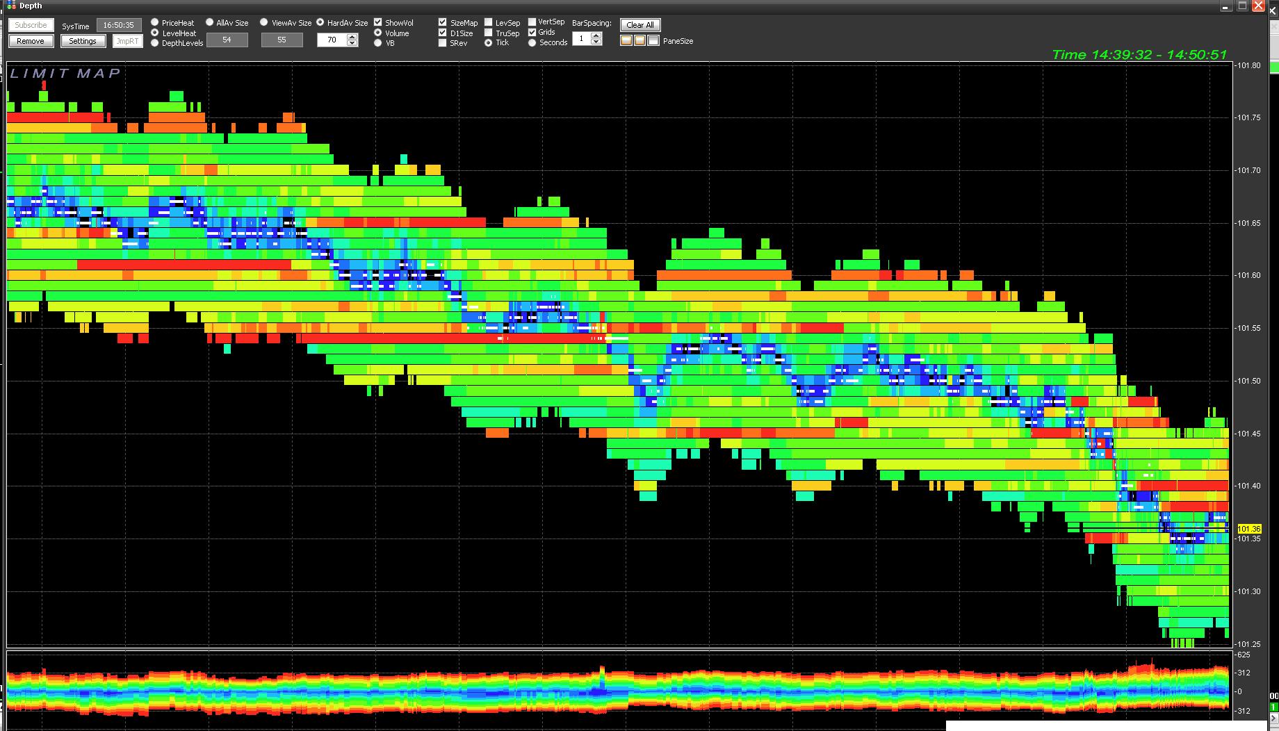

norvik - Posts: 22
ejtrader , thank you for your feedback. sc.UseTool is a greate feacher, but at some situations i prefer to draw without any limitations.
I have software, which can plot DOM historically, it is a modyfied original code of JTools (NANEX LLC). I have to export time&sales and DOM data from SierraChart to another application in real time , debug and support several thousand strings source code program. It is really convenient to use ASCIL study and apply it directly to SC charts..
So, I hope SC Team will improve this function.
Date Time Of Last Edit: 2014-04-25 13:01:56
imageDepth.jpg / V - Attached On 2014-04-25 12:51:35 UTC - Size: 294.84 KB - 6431 views
[2014-04-25 13:05:06]
norvik - Interesting way you are using this and agree with you about the number of possibilities if GDI function can be improved :)
Thanks.
