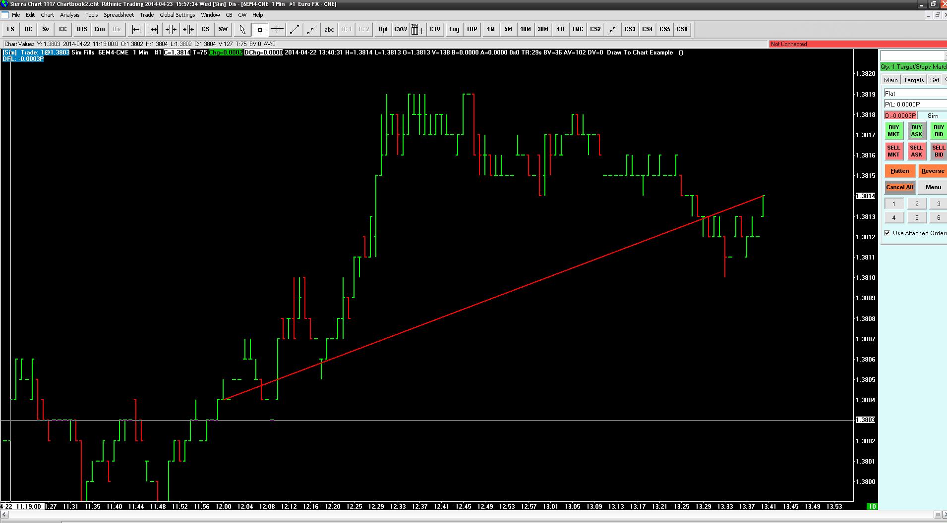

Dear SC Support,
I have a problem with drawing using sc.p_GDIFunction. Study is calculated only when it is applied on the chart or when I
press "Recalculate" at the chart menu. After I do some interactive action with chart, moving or scrolling, I see a wrong drawing result.

imageAfterApplyingStudy.jpg / V - Attached On 2014-04-23 14:00:37 UTC - Size: 169.98 KB - 831 views
imageAfterResizingBarSpacing.jpg / V - Attached On 2014-04-23 14:00:46 UTC - Size: 181.66 KB - 750 views
