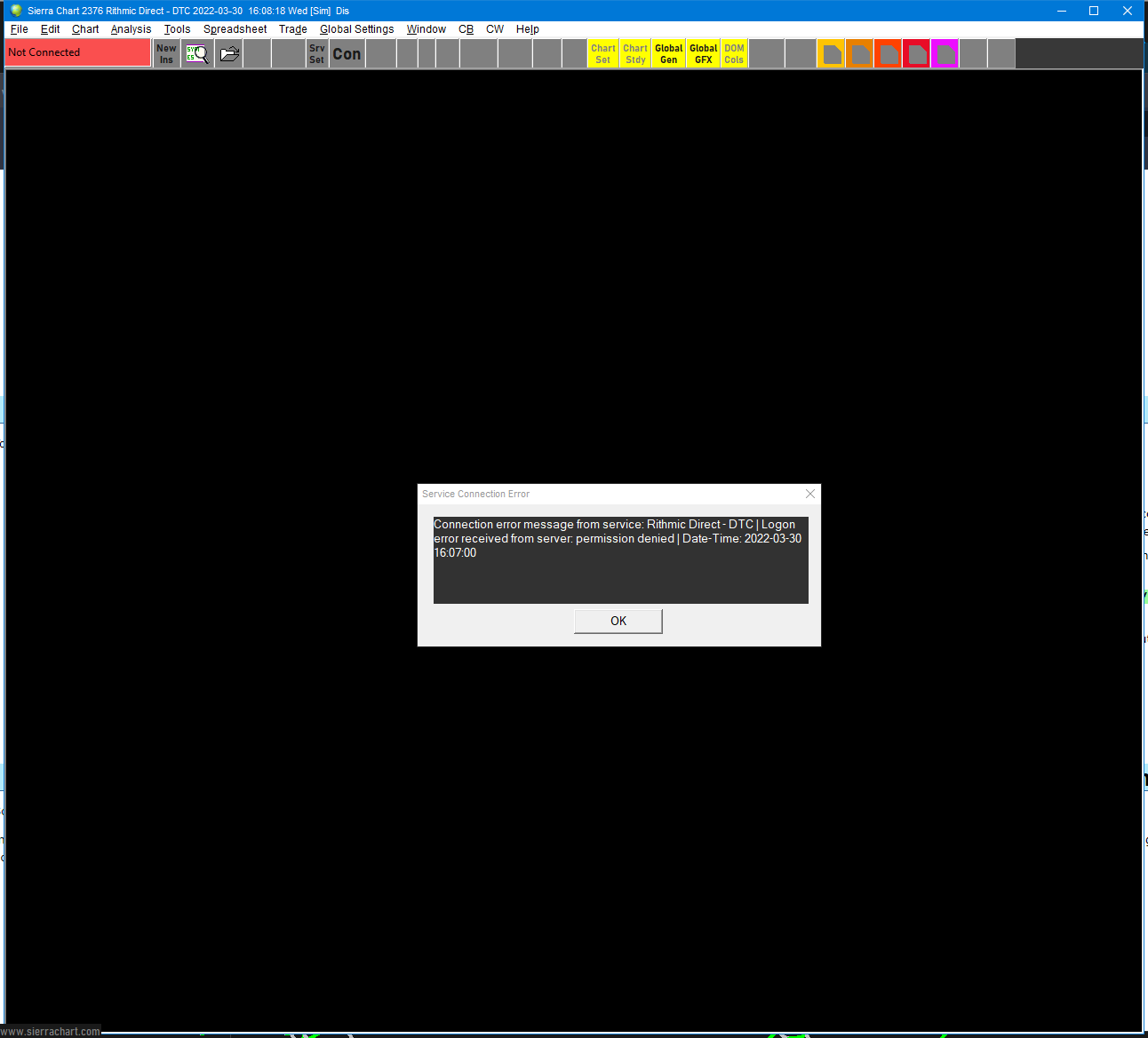

[2022-03-30 20:10:42]
Mayuri - Posts: 5
Have the same issue with tickticktrader. Though, i have paid for Denali :
https://www.sierrachart.com/image.php?Image=1648670903161.png
Can you help me ?
I heard that it is the number of characters in the password that may be too long ?
[2022-03-30 20:23:30]
Yes, it could be that the Password is too long, but definitely the Account Name that is assigned needs to be less than 31 characters for Sierra Chart to be able to handle it.

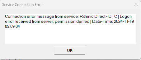

[2024-11-19 14:15:42]
User273277 - Posts: 145
Please see attached.
The error is "Connection error message from service: Rithmic Direct - DTC | Logon error received from server: permission denied | Date-Time:..."
imageScreenshot from 2024-11-19 09-09-08.png / V - Attached On 2024-11-19 14:14:05 UTC - Size: 5.95 KB - 306 views
imageScreenshot from 2024-11-19 09-12-11.png / V - Attached On 2024-11-19 14:14:09 UTC - Size: 84.01 KB - 298 views
[2024-11-19 17:07:07]
Refer to the following:
Rithmic Trading Platform Service: Permission Denied Resolution Procedure
[2024-11-19 19:59:34]
Thank you. I did go through that page before posting, and I sent the information to TickTick.
They already reduced my password length, but that did not fix it.
Is there any additional logging I can enable to see what the denial is for?
[2024-11-19 23:30:06]
Unfortunately, that error comes from Rithmic, and all the items we know to try are in the documentation at the link we gave. We do not know of any other things that can be done to resolve the issue.
