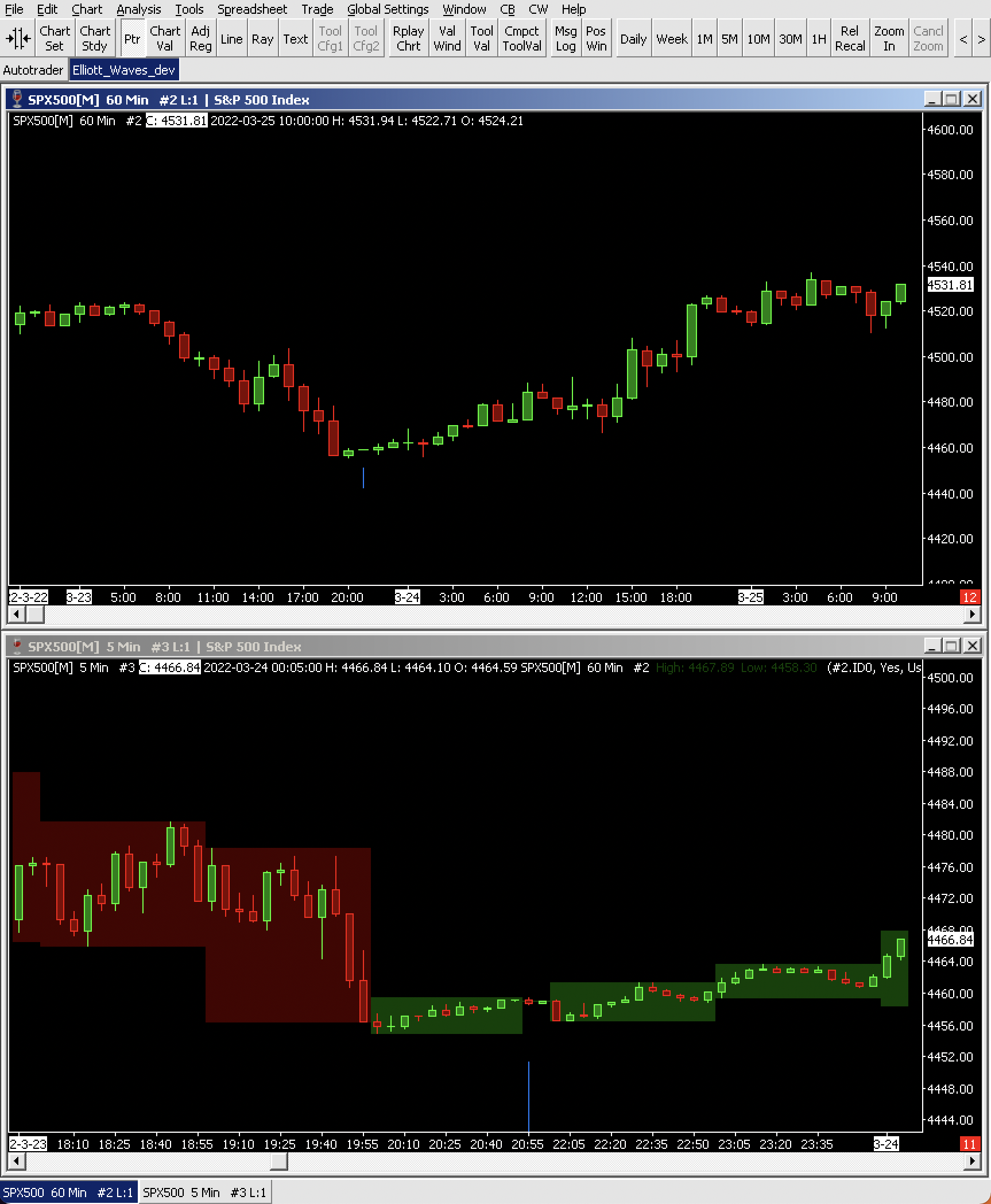

I'm running Study/Price Overlay on a 5m showing 60 min bars.
The Study/Price Overlay has a bug at the end of the day where the 20:55 bar on 2-3-23 is considered part of the 21:00 bar, not the 20:00bar.
Also separately the studies hollow subgraph drawing line uses Line instead of square, this makes it very hard to see where the higher timeframe bars start/end. Is this meant to be square instead? The study also resets the settings so I can't make this change myself.

This is probably due to the settings for your Study/Price Overlay, but the easiest thing is for us to take a look at how you have this setup.
Please get us a copy of your Chartbook by following these instructions:
With regards to changing the subgraph settings, you need to tell the Study/Price Overlay to allow you to change the subgraph information by setting the appropriate Inputs to No, such as Use Styles and Widths from Source Study. Refer to the information here:
Study/Price Overlay Study: Use Styles and Widths from Source Study
