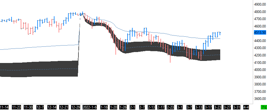

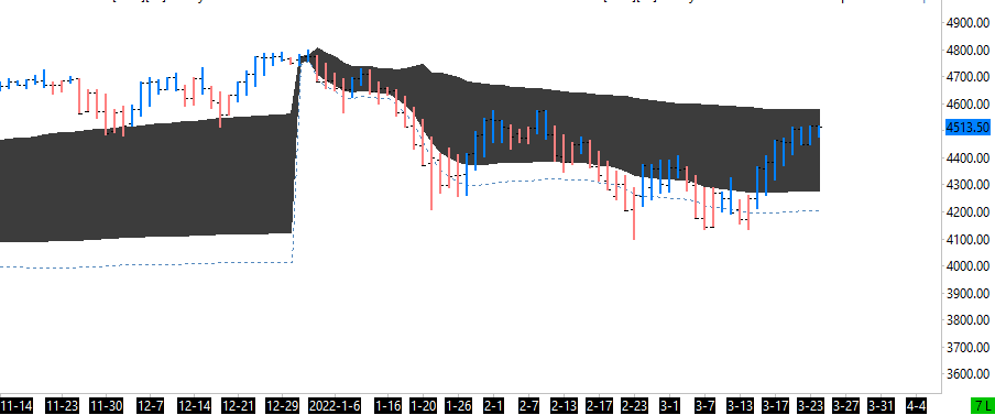

I'm struggling to figure out how to get a certain style rendered on my chart. I'm using VWAP and would like to have the following:
* From VWAP to +/- VWAP+1 Std Dev, white background
* From VWAP+/-1 Std Dev to VWAP+/-2 Std Dev, colored background
* From VWAP+/-2 Std Dev and beyond, white background
I can successfully get either the top or bottom to render using "Fill Top". However, when I do the other side, I end up with a skewed render. In my settings, Extension 2 is VWAP+/-1 and Extension 4 is VWAP+/-2. I've tried a combination of Fill Top/Bottom at Extension 2, colored, in combination with Extension 4 Fill Top colored white, or ignored. The only thing I can get to work is one side. For instance, Extension 2, Fill Bottom Colored with Extension 4, Fill Bottom White. That combination gets me the image below.
* vwap-bottom-correct.png - This is what it should like, but with bands on both sides of the VWAP+/-1 Area, without extending beyond VWAP+/-2
* vwap-add-top-to-bottom.png - This is what happens when I replicate the top side to the correct bottom.
Can you help me identify what I might be doing incorrectly or if there's a defect or design limitation?

[2022-03-25 15:09:31]
John - SC Support - Posts: 48438
You would need to use 2 instances of the Study Subgraph References study to do what you want. In each one you will specify the subgraphs from the VWAP for which you want the coloring in between.
You can not do it directly in the VWAP study as you are wanting multiple coloring options for a subgraph.
