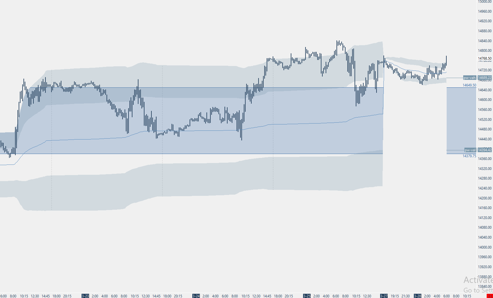

Hi. Your last suggestion was great. Thanks for helping.
I'm almost there, but having an issue with one last thing. I'm using the Study Subgraphs reference. That renders what I want on the screen. In order to get the bands, I'm using a transparent fill above and below SG2 (for example) which extend all the way to the top and bottom. In order to cut the bands off, I'm using a solid fill above and below SG4. That produces what I want. However, when I draw over the SG4 area, it's overlayed above the drawing, hiding it. If I uncheck "Draw Study Underneath Main Price Graph", then my candles that go above and below the band area are hidden. So, I'm stuck. Any help is appreciated.
image2022-03-28 07_41_19-DESKTOP-K0QOQQF.png / V - Attached On 2022-03-28 12:46:11 UTC - Size: 48.76 KB - 824 views
