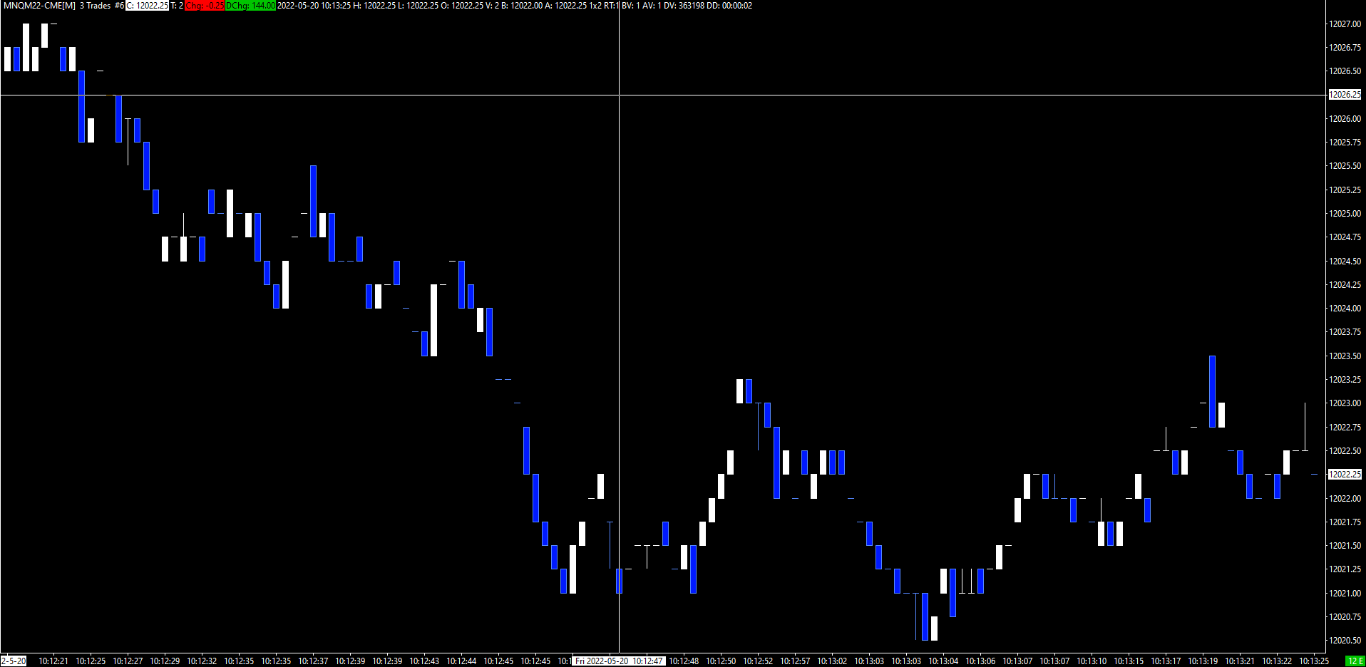

User569346 - Posts: 4
https://www.sierrachart.com/image.php?Image=1653052407425.png
[2022-05-20 13:16:31]
By the way, how can you detect the movement using a static image as requested?
[2022-05-20 17:24:26]
We want to see what studies are on the chart. Looks like there are none. Not really sure there is any solution to this issue, at least as we understand it. The scale is going to automatically adjust as needed based upon the current range and with 3 trades per bar there can be a lot of scrolling occurring and scale adjustments at times. What you are seeing is based upon actual operational fact. Nothing really wrong.
You could try a Constant Range Scale:
Chart Scale and Scale Adjusting: Scale Range (Scale Settings)
Otherwise, we cannot think of a solution.
