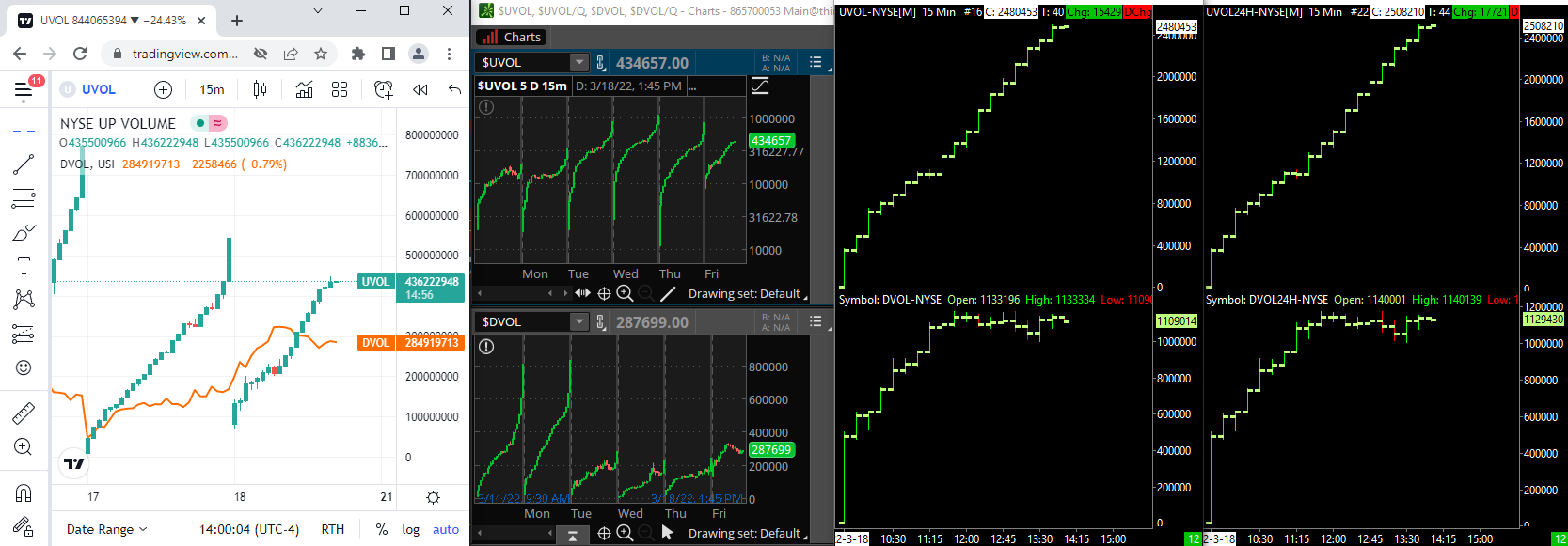

I am trying to leverage the UVOL/DVOL Market Statistics but having difficulties reconciling the data.
The statistics are very different from other data providers. I have attached an image of the discrepancy from today.
What the image show is:
TradingView: UVOL 436,222,948 DVOL 284,919,713
ThinkorSwim: $UVOL 434,657 DVOL 287,699
SierraChart: UVOL-NYSE 2,480,453 DVOL-NYSE 1,109,014
SierraChart: UVOL24H-NYSE 2,508,210 DVOL-NYSE 1,112,430
As shown, the TradingView and ThinkorSwim (1000's) stats are statistically similar.
The SC stat is significantly different:
If, as the documentation states, the stat is in thousands, UVOL/DVOL are significantly larger than the TV & TOS platforms
TV:   436,222,948   284,919,713
SC:  2,480,453,000  1,109,014,000
Diff:    569%   389%
If the UVOL/DVOL are actually are in hundreds the numbers are smaller than the TV & TOS platforms
SC: 248,045,300    110,901,400
Diff: -76%     -157%
Either way the differences are statistically significant and I am struggling to reconcile the stats to utilize them.
I thought perhaps I needed to use the UVOL24H/DVOL25H stats but they do not improve the discrepancy either in the thousands or hundreds.
SC: 2,508,210 1,129,430
In todays stats, the morning session had down volume higher on the TV & TOS platforms but lower on SC.
Would you help me understand discrepancy so I could leverage the UVOL/DVOL? Using UVOL/DVOL in formulas produces different results from other platforms.
Thank you.
image2022-03-18_14-00-19.png / V - Attached On 2022-03-18 19:02:45 UTC - Size: 119.77 KB - 488 views

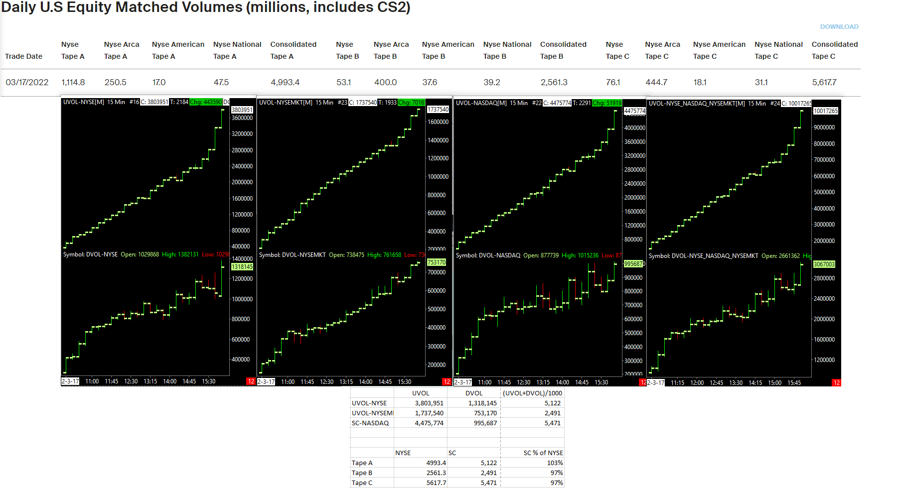

[2022-03-18 21:34:03]
User796776 - Posts: 95
I reviewed the consolidated tape values from 3/17/22 and the documentation on Tape A, B, C at nyse.com and I think I understand.
UVOL-NYSE correlates with Consolidated Tape A, NYSE
UVOL-NYSEMKT correlates with Consolidated Tape B, Arca, American, BZX
UVOL-NASDAQ correlates with Consolidated Tape C, NASDAQ
NYSE Tape A: 4993.4 SC UVOL-NYSE: 5122 +3%
NYSE Tape B: 2561.3 SC UVOL-NYSEMKT: 2491 -3%
NYSE Tape C: 5617.7 SC UVOL-NASDAQ: 5471 -3%
Correct?
Date Time Of Last Edit: 2022-03-21 13:31:08
image2022-03-21_09-17-37.png / V - Attached On 2022-03-21 13:30:20 UTC - Size: 92.18 KB - 288 views
[2022-03-21 19:23:51]
No, you would have to look at the TVOL24H-NYSE values and make comparisons only to that symbol. Or perhaps TVOL24H-NYSE_NASDAQ_NYSEMKT
And an NYSE stock, can trade anywhere including NASDAQ.
And you really you have to probably add together Consolidated tape ABC. But we really do not have sufficient inside knowledge to give any 100% definite answers in regards to all of this.
