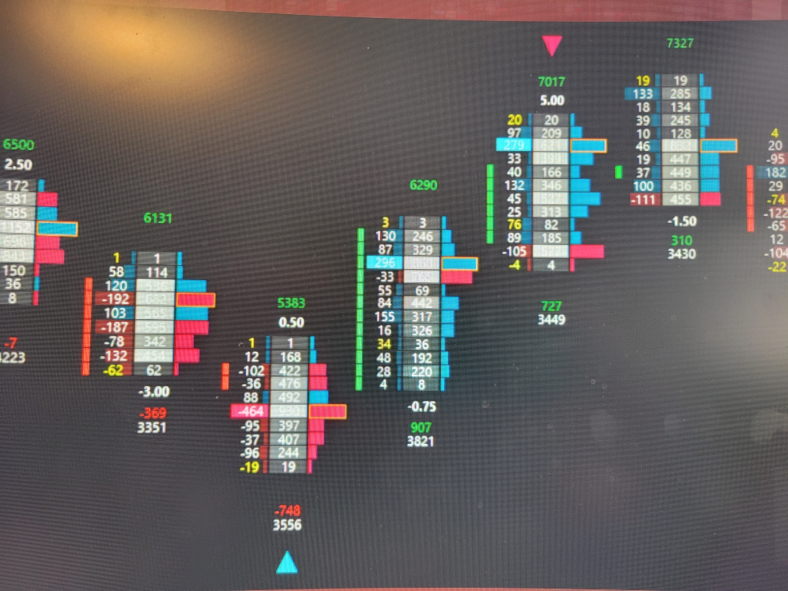

I am trying to find out why several traders I follow use this platform but their charts and studies don't look like anything I have seen on your images for studies platform etc.. Can you confirm this picture of a chart study is Sierra Charts platform? Do you have to be able to write code to customize the studies and charts in your packages? Or are there customizations you can upload for your charts to look more modern. Attached a photo
attachmentResized_20220317_090444001.jpeg - Attached On 2022-03-17 14:10:15 UTC - Size: 611.14 KB - 704 views

That definitely could be a Sierra Chart screenshot. The main study being used is the Numbers Bars study and in this case there are 3 different columns being used along with the Open to Close markers on the left side. Refer to the documentation for this study here:
Numbers Bars
There are also a couple of Study Subgraph Above/Below Bar as Text studies being used. Refer to the information here:
In terms of coding to customize studies and charts, refer to the information here:
Advanced Custom Study Interface and Language (ACSIL)
