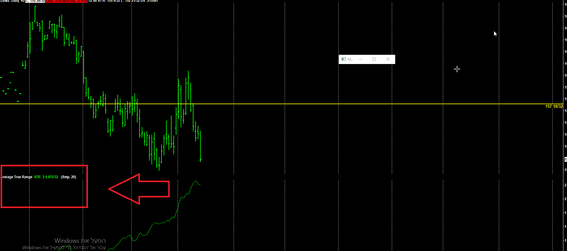

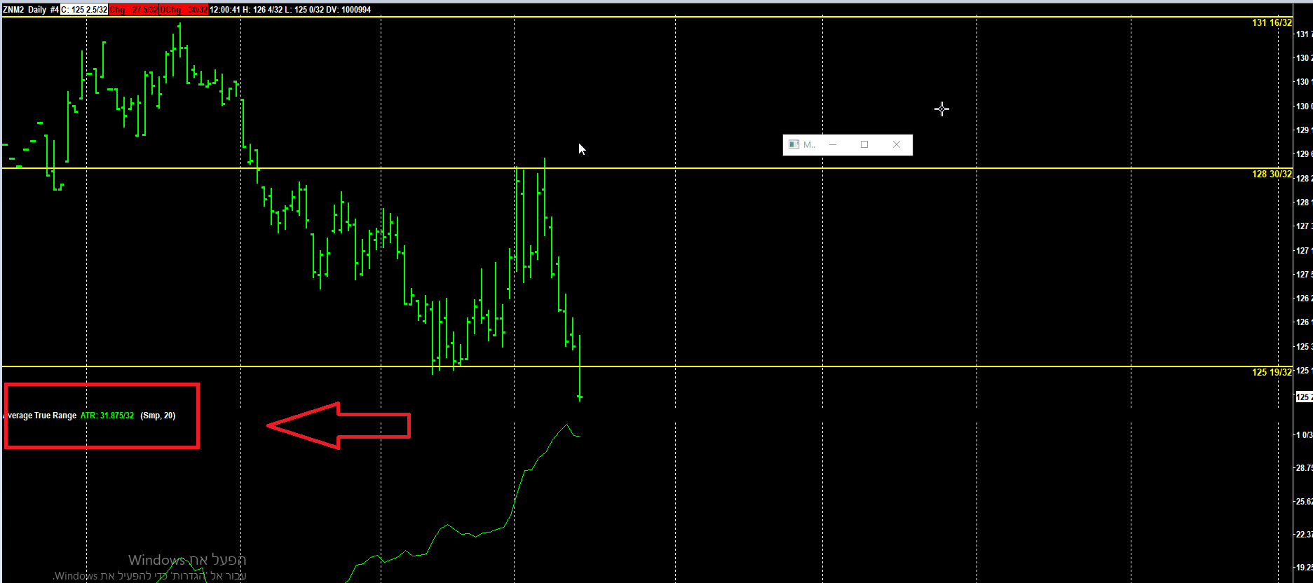

Hi there, how should I read those ATRs?
pictures added
Thank you
imageimage.png / V - Attached On 2022-03-15 05:24:42 UTC - Size: 43.82 KB - 412 views
imageimage (1).png / V - Attached On 2022-03-15 05:24:49 UTC - Size: 39.73 KB - 371 views

Hi User795226,
They are in the same units as the price of ZB itself, which are points and 32ths of a point.
The first means 0 points and 31.875 / 32 of a point.
The second means 2 points and 6.875 / 32 of a point.
Does that make sense?
