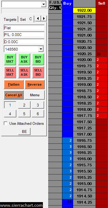

andrusha777 - Posts: 5
I have been having constant issues with MQOJ not working. On other platforms the quote is updating as it should.
[2022-03-14 21:53:27]
We can not find a U.S. Stock with that symbol. What company is this and what exchange is it traded on?
[2022-03-14 21:58:45]
The mini gold contract. F.US.MQOJ22 . The symbol names on here are different than usual.

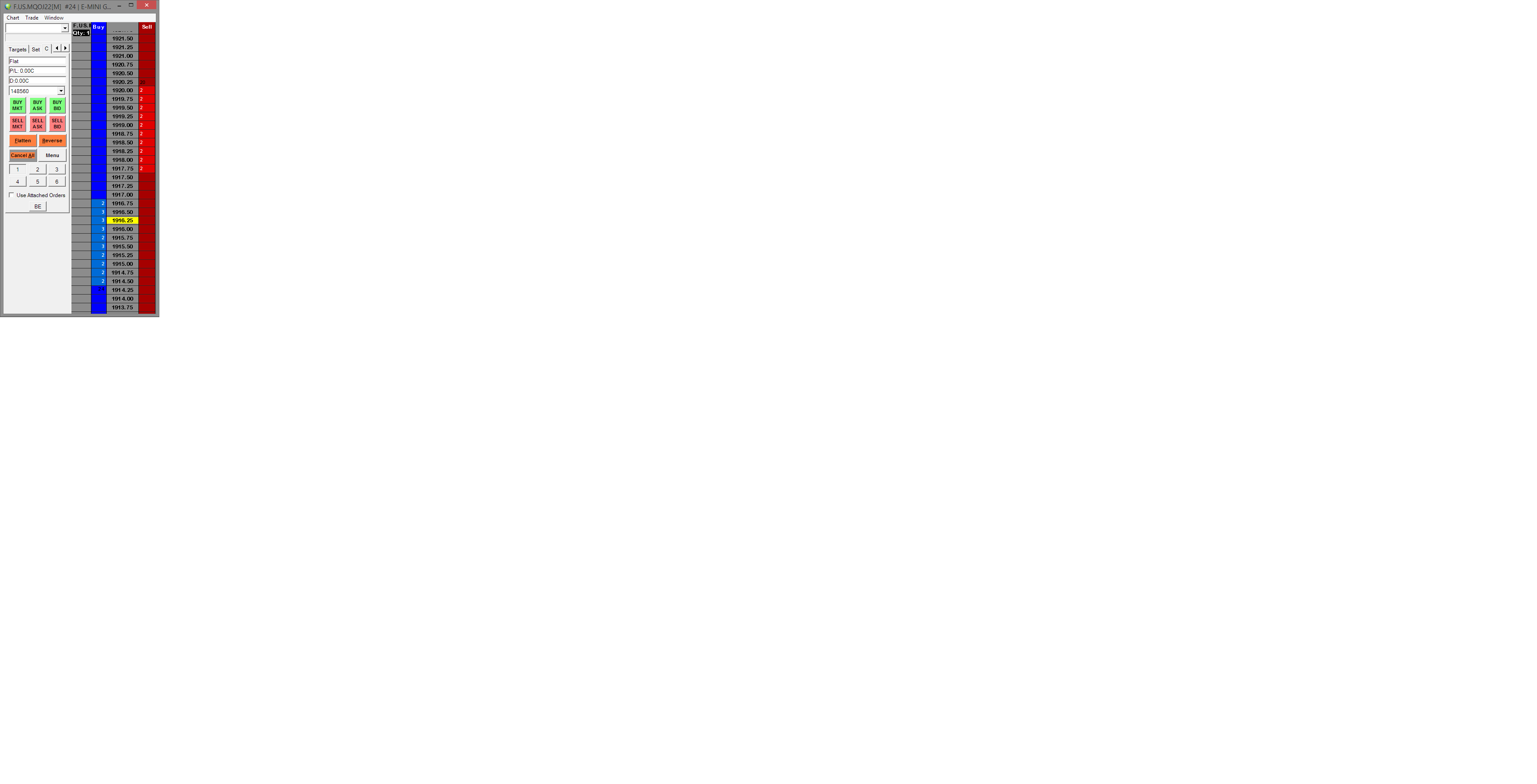

[2022-03-16 19:17:31]
https://www.sierrachart.com/image.php?Image=1647458227185.png
https://www.sierrachart.com/image.php?Image=164745831333.png
Date Time Of Last Edit: 2022-03-16 19:18:50
imagemqoj.png / V - Attached On 2022-03-16 19:13:28 UTC - Size: 66.27 KB - 297 views
[2022-03-22 00:45:11]
This is not unusual to see in a market like that, which has limited liquidity. Ultimately, you should be consulting with the exchange. The data is definitely correct. You may very well see the last trade price significantly away from the current bid/ask. Completely expected in a low liquidity market like that.
There is nothing wrong here at all. Nothing. Prove to us there is a problem. Get us information from the exchange proving there is a problem. Provide proof.
Date Time Of Last Edit: 2022-03-22 00:46:21
