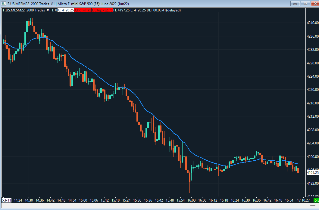

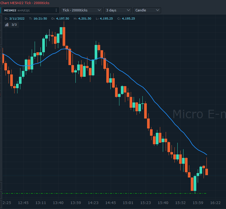

[2022-03-13 15:45:19]
User260434 - Posts: 14
here is an image of a 2000tick chart from sierra and one from another chart platform.
imagesierra.png / V - Attached On 2022-03-13 15:39:53 UTC - Size: 32.1 KB - 893 views
imageother chart.png / V - Attached On 2022-03-13 15:40:26 UTC - Size: 27.28 KB - 938 views

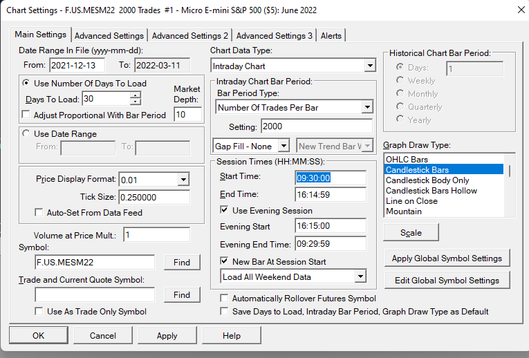

[2022-03-13 15:54:09]
Here are the chart settings for the sierra 2000 tick chart.
Also, I have verified the non sierra chart is a correct 2000 tick chart using another third chart platform I have.
imagesierra chart settings.png / V - Attached On 2022-03-13 15:51:12 UTC - Size: 55.67 KB - 510 views

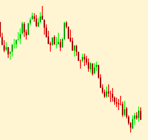

[2022-03-13 16:26:23]
Tony - Posts: 731
That is weird, I have Denali + IB, my 2000-tick bars on Sierra Chart looks almost identical with your "other_chart.png", very different than your "sierra.png" (see attached image).
So, the difference is not caused by Sierra, but the data feed, hope Sierra team would know what went wrong.
By the way, I would set evening session from 18:00 (assuming your time zone is Eastern), that is when new day start. But that has nothing to do with the difference we are discussing.
Date Time Of Last Edit: 2022-03-13 16:32:30
imageOthers.png / V - Attached On 2022-03-13 16:26:14 UTC - Size: 12.29 KB - 410 views
