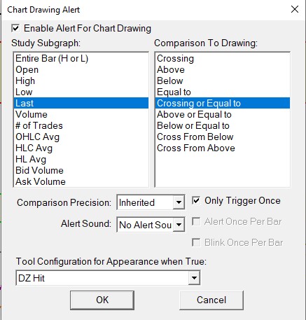

Thanks, I changed the configuration to what I want but it isn't working the way I need it to. If I draw the extended rectangle below price (and vice versa), I want it to change to the configuration that I setup but it isn't doing that.
My alert settings are:
1 - enabled,
2 - set to only trigger once,
3 - set to crossing or equal to
4 - tool config set to what I want.
I also tried using "cross from above/below"
I'm getting 2 problems:
1 - if my setting is "crossing or equal to", while I am drawing the extended rectangle on my zone, it would change to my triggered setting. So I would draw my zone and while price is far away the other setting goes on
2- If my setting is "cross from above/below" the drawing works sometimes. This I don't understand because once price crosses I want to see that my zone changes color. It worked on some zones and not others and I checked the settings and they are what I listed above.
Is there another setting I am missing or did I not set this up correctly?

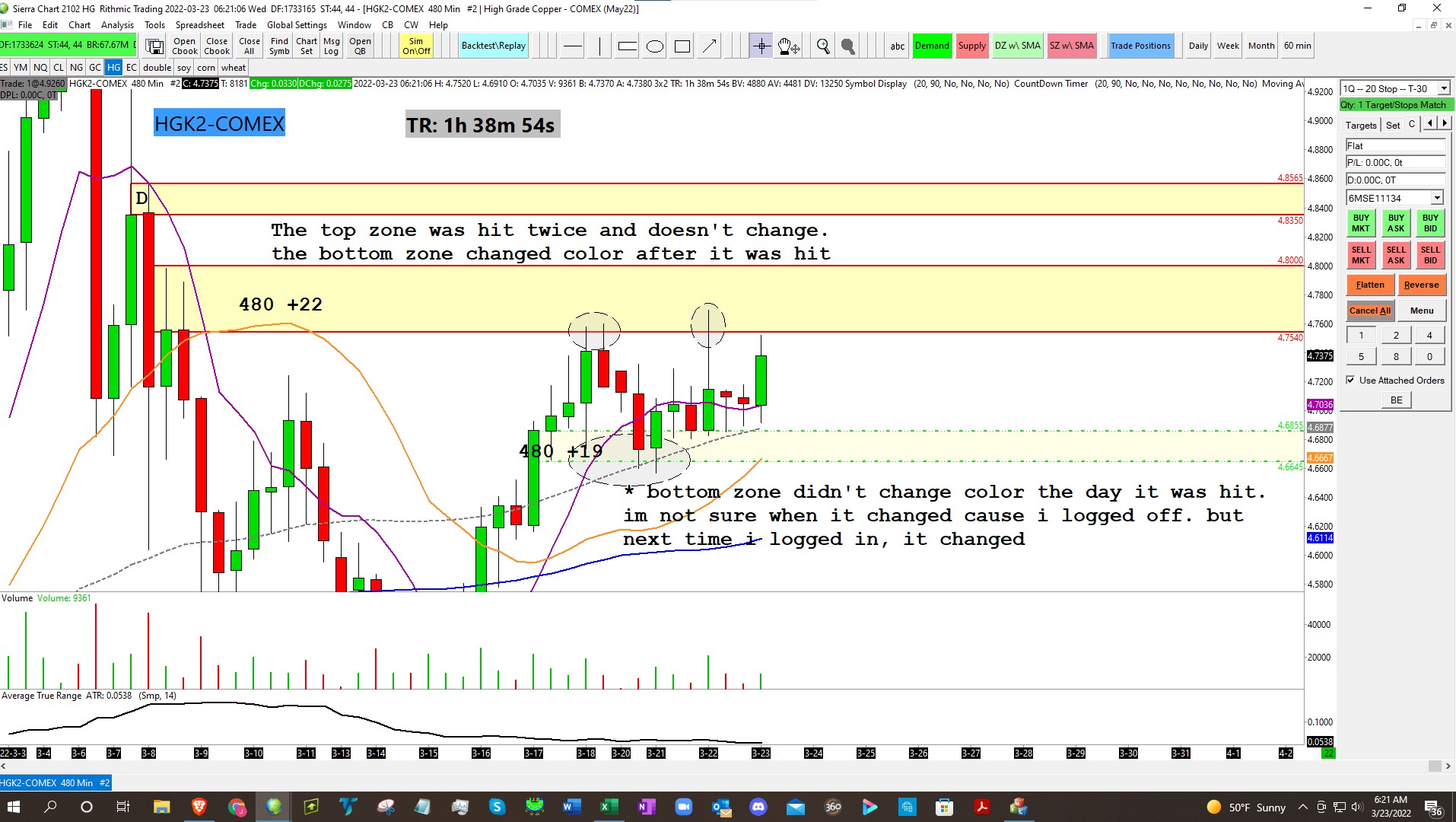

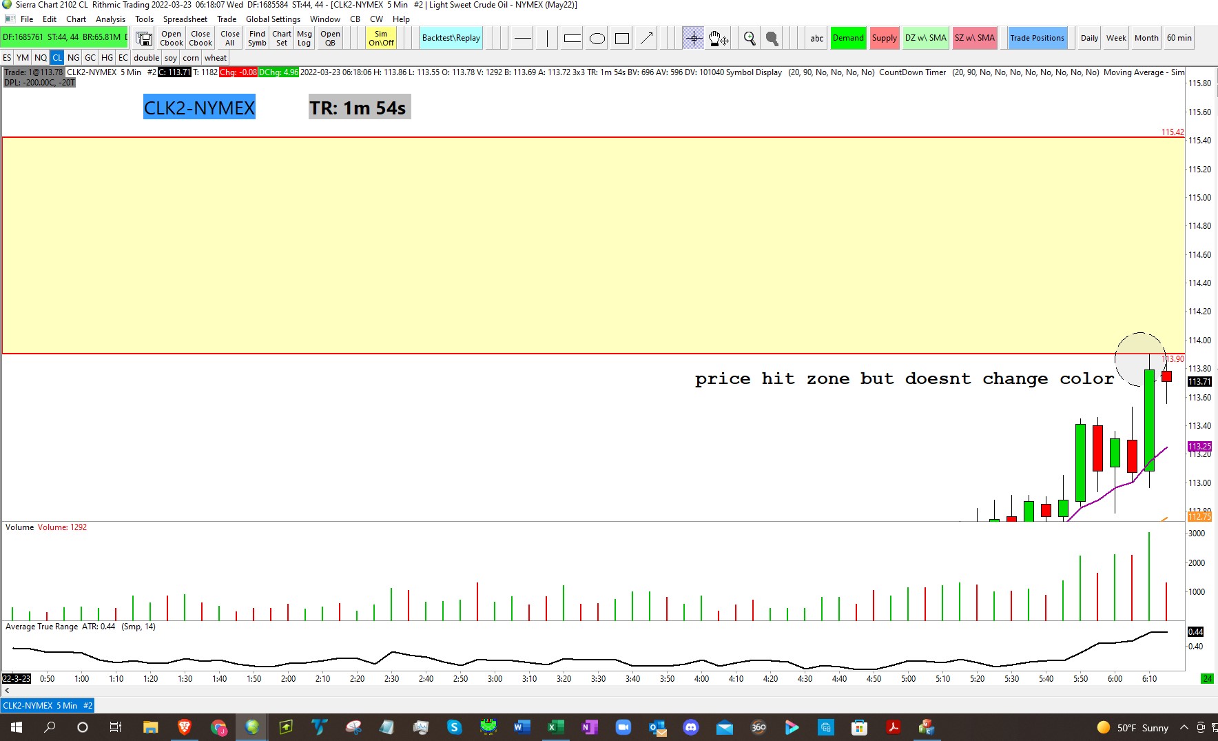

[2022-03-23 13:24:18]
User386175 - Posts: 31
I added a few screenshots of my settings and a few problems I am encountering. Thanks for your help with this
image01 - changed.jpg / V - Attached On 2022-03-23 13:23:17 UTC - Size: 387.59 KB - 236 views
image01 - hit zone doesnt change.jpg / V - Attached On 2022-03-23 13:23:29 UTC - Size: 239.14 KB - 300 views
image03 - settings for all zones.jpg / V - Attached On 2022-03-23 13:23:36 UTC - Size: 51.7 KB - 235 views
[2022-03-23 15:06:16]
First we want you to update to the latest version and see if there is any change. We do not provide support for older versions.
