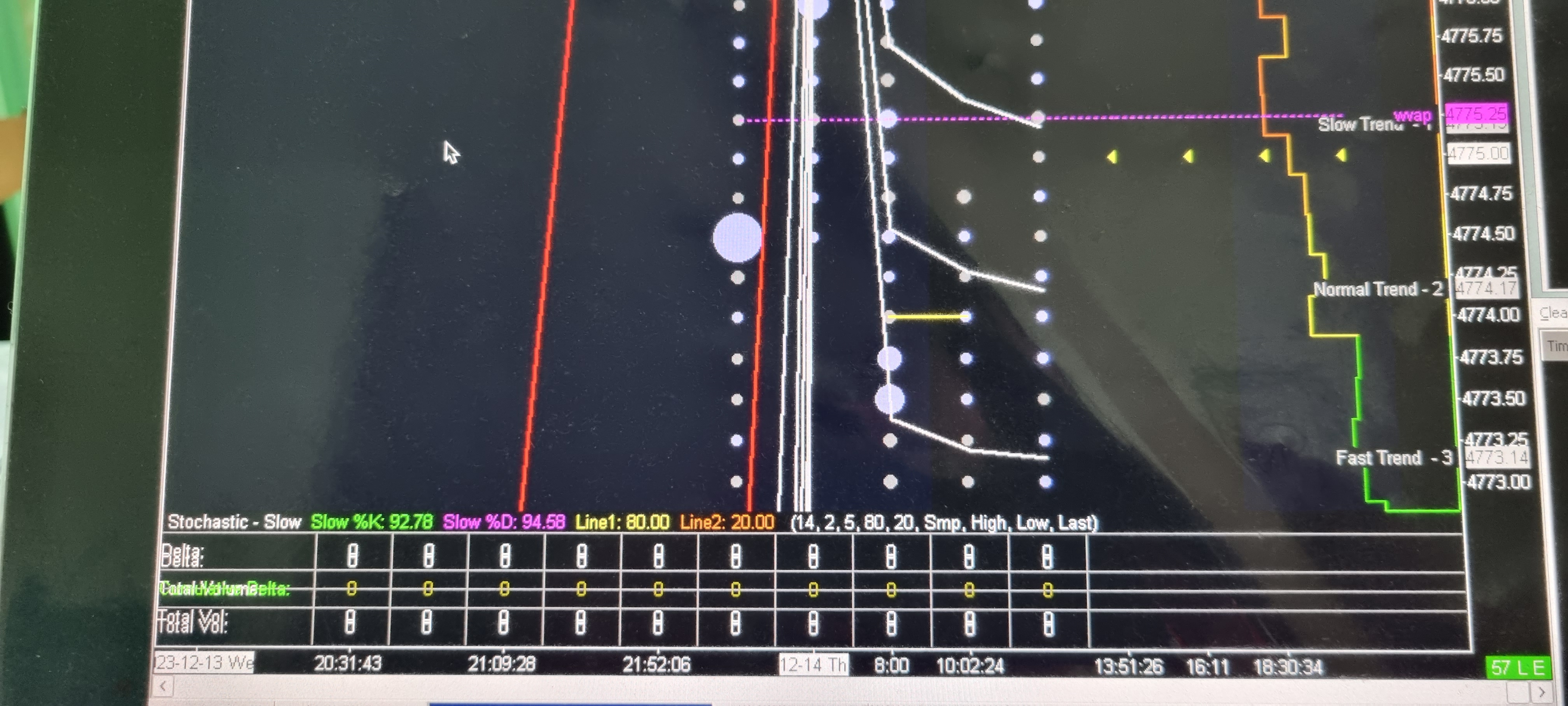

User513390 - Posts: 49
Dear John -SC Support,
Thanks for your support.
This Input is a comma separated list of study Subgraph numbers (1, 2, 3, ...)
I should use 1,or 1
As it is not displaying this order:
1. Total Volume
2. Delta
3. Cumulative Delta
Also having 2 times delta and Total Volume showing.
image20240106_121059.jpg / V - Attached On 2024-01-06 11:14:33 UTC - Size: 6.88 MB - 414 views
image20240106_121155.jpg / V - Attached On 2024-01-06 11:14:43 UTC - Size: 7.1 MB - 295 views
[2024-01-08 16:23:54]
John - SC Support - Posts: 48446
You need to order the subgraph numbers according to what you want. Since you have 3 subgraphs displayed, you would need to enter all 3 subgraph numbers in the order you want them to show up, such as the following "15, 7, 11" (these are example numbers, you need to use your specific subgraph numbers).
With regards to the doubling of the information, do you have more than one Numbers Bars Calculated Values studies in that region? If so, then you need to move one to another region. Also, it looks like you have another study (Stochastic) also displayed in that same region. You can not have any other studies in the same region with the Numbers Bars Calculated Values.
