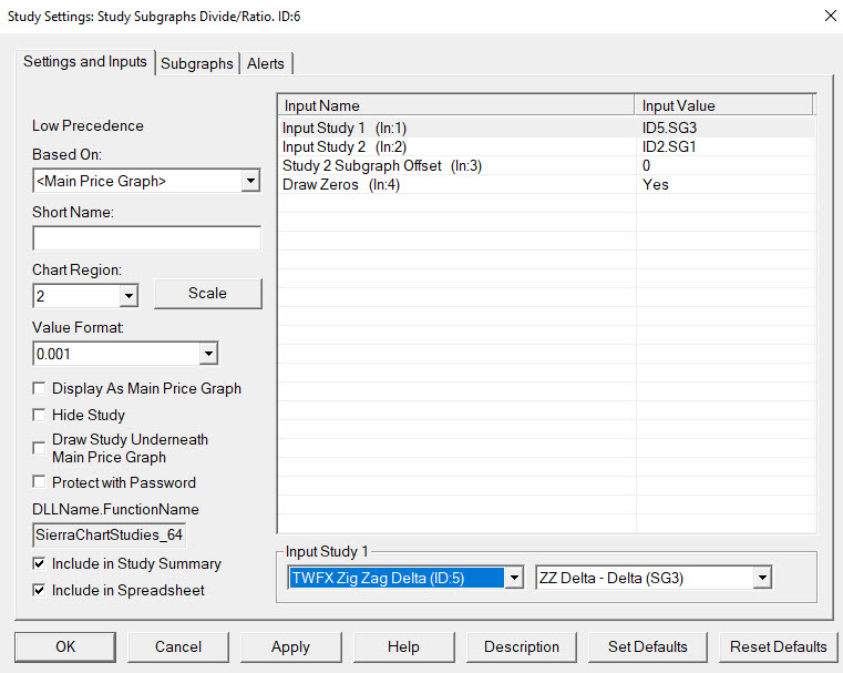

I'm trying to plot an indicator resulting from the ratio between 2 Study subgraphs indicators (Zig Zag Delta / Zig Zag Oscillator) I thought "Study Subgraphs Divide / Ratio" could be the solution, I've put it on but I see that is it non calculating correctly, manually checking the result it shows wrong, on the attached image you can see the evidence for the rotations considered: 2 different rotations (the first one is larger) and the 2 corresponding detla values (at the numerator) the Study Sugraphs shows 2 equally resulting values which is wrong.
Do I miss something or I'm doing something wrong?
Definitely I want to do a very simple thing, divide (for the same rotation) the Delta with the lenght of the rotation...
Tks for the help
Regards
R.
imageStudy Subgraph divide ratio.jpg / V - Attached On 2022-02-18 14:39:15 UTC - Size: 300.11 KB - 332 views
imageSetting Study1.jpg / V - Attached On 2022-02-18 14:44:01 UTC - Size: 123.41 KB - 248 views

User907968 - Posts: 885
You need to change ID2.SG1 to ID2.SG9
For the zig zag study SG1 = zig zag & SG9 = zig zag oscillator

User75949 - Posts: 142
Thank you for the answer, yes I tryed but the indicator is unreadable, I need to to divide the delta value per number of points of the rotation..having a kind of representation as the one showed above... but with correct values..

It is not possible for the "Study Subgraphs Divide / Ratio" to be giving wrong values. That is impossible. It is doing exactly what it is designed to do.
You must be referencing the wrong Input data, or perhaps there is a study calculation order issue:
Chart Studies: Study Calculation Precedence And Related Issues
