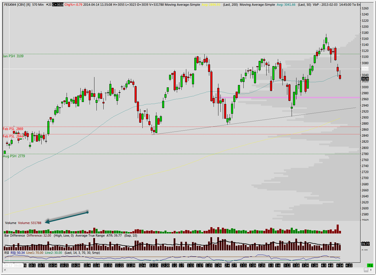

Today my SierraChart feed shows FESX vol at 521k around 11:30 CET.
My OEC data feed shows vol at 287k. The eurex website (15 minutes delayed) shows 278k.
I also saw huge volume on Friday (almost 2 million contracts) whereas the Eurex stats page shows 1.36 million contracts.
Can you please check into this.
-Steve
image14-04-2014 11-35-19.png / V - Attached On 2014-04-14 09:35:53 UTC - Size: 58.59 KB - 529 views

[2014-04-14 10:03:10]
corbeste - Posts: 74
I only see the elevated volume when looking at intraday data - I can confirm the historical chart reports the correct volume.
I use a 570m intraday chart for my daily, which is why it shows up in the chart I sent you.
[2014-04-14 10:05:43]
The data feed is definitely good. No problems.
We cannot comment on what you are seeing because it is using data from a remote instance and we do not have the Chartbook and we do not know the time zone setting.
You might want to re-download the data following the instructions in help topic 2:
http://www.sierrachart.com/index.php?l=doc/helpdetails2.html
Also set the chart bars to 1440 minutes per bar.
[2014-04-14 10:18:39]
I use two copies due to timezone issues from daylight savings, but only one instance connects to the data feed.
After re-starting and re-downloading, it looks fine.

[2014-04-14 16:38:10]
I think I may have connected to both the OEC demo and production account at the same time - as my EuroStoxx instance had the demo credentials and was connected. There is no need to connect to both, so I disabled the demo account in the EuroStoxx instance and used the production instance as the only data source. I think SierraCharts was double counting the volume due to this.
More of a user error than an issue with SC I think.
[2014-04-14 16:44:01]
OK, then this is the reason for the problem. And we would never have been able to figure this out from our side. It would be impossible for us to know something like this was happening.
This indicates, you are sharing the Data Files Folder between two copies of Sierra Chart and we strongly recommend not to do that. This is explained at step 15 here:
http://www.sierrachart.com/index.php?l=doc/MultipleServices.html#Sharing
