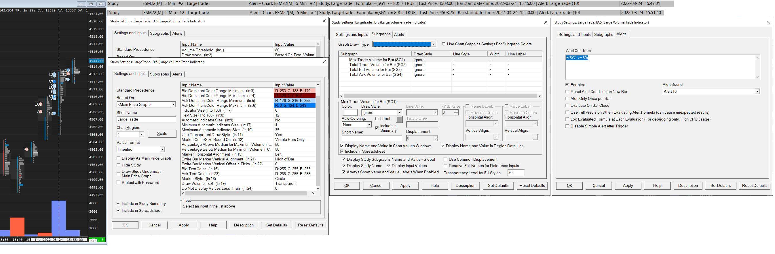

I noticed that the "Alert Sound" for this indicator (Large Volume Trade) only plays once per bar even though the "Alert Only Once per Bar" is NOT checked. In fact, the only thing that is checked is "Enabled". I wonder if that's just how it is or I've not configured something properly. The sound would play again on a new bar if the threshold is hit again though.
Thanks.

Thanks for your response. I set it to 80 for the threshold. I've combined all the screenshots into one picture so you can see it all at once. The left side is the chart of today's ES. If you look at it, you see the last few bars have many large volumes displayed but it only generated 2 alerts from the Alert Manager (top of the picture). The rest are the 3 tabs of the settings for the study itself. From the log, it looks like it only alerts once per bar. I tried with 2 as the threshold to test it with a lower number and it was the same. I also tried the formula (SG1>0) as well - same results, one alert.
imageLarge Volume Trade.png / V - Attached On 2022-03-24 20:38:17 UTC - Size: 160.17 KB - 390 views

You have us rather confused. The Large Volume Trade Indicator does not create "alerts" directly. In other words, each time a marker is printed on the chart, there is not an Alert created, so there will not be anything in the Alert manager.
The reason you got the two alerts was from when you added the information in the Alert tab with the formula =(SG1 >= 80). In this case, whenever the Maximum Trade Volume got above 80 for a bar, you would then get an alert.
If you tell us exactly what you want to accomplish, then we can help you get it setup, but we do not understand exactly what you are trying to do at this time.
[2022-03-25 01:09:21]
NeoCore - Posts: 46
I see. So that's where I got it wrong. I thought that each time a large volume trade hits the threshold and there's a condition set under the "Alerts" tab then that condition would get evaluated every single time as well, and therefore, it would play the sound each time too. The thing is that it would get evaluated again the next bar though.

[2022-03-25 13:56:45]
There is not a way to do exactly what you want. You can get the first notification of a large trade that is greater than a certain amount, but since the Alerts are setup to require a False to True state, there is not a way to get any additional notifications.
The only way to do this would be to create a custom study that checks the volume and then gives an alert when that volume changes. Refer to the information about creating custom studies starting here:
