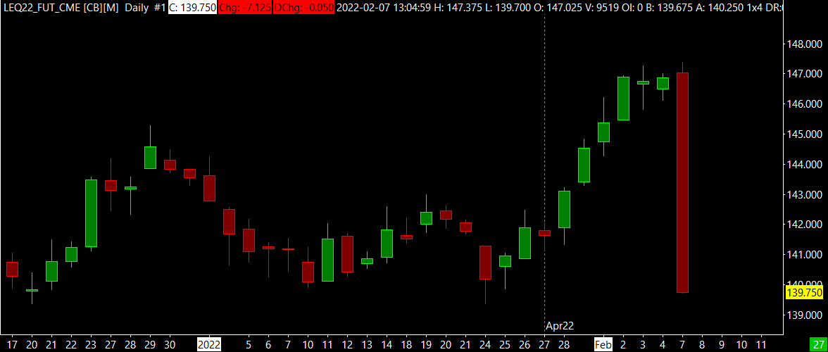

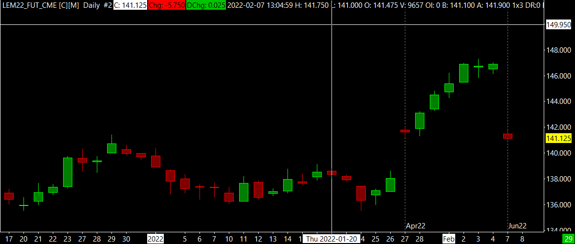

I am trying to do a Continuous June Live Cattle Chart. The past few days are on charts higher than they should be.
Chart should look similar to attached chart.
https://www.sierrachart.com/image.php?Image=1644277157643.png
imageLEM22.png / V - Attached On 2022-02-07 23:42:07 UTC - Size: 28.73 KB - 354 views

User841161 - Posts: 357
How about LEQ22- changed to date rollover and back adjusted. Has big candle for today, wrong prices for past days.
https://www.sierrachart.com/image.php?Image=1644294102388.png
Continuous chart should look similar to attached
imageLEQ22.png / V - Attached On 2022-02-08 04:24:42 UTC - Size: 29.41 KB - 256 views
