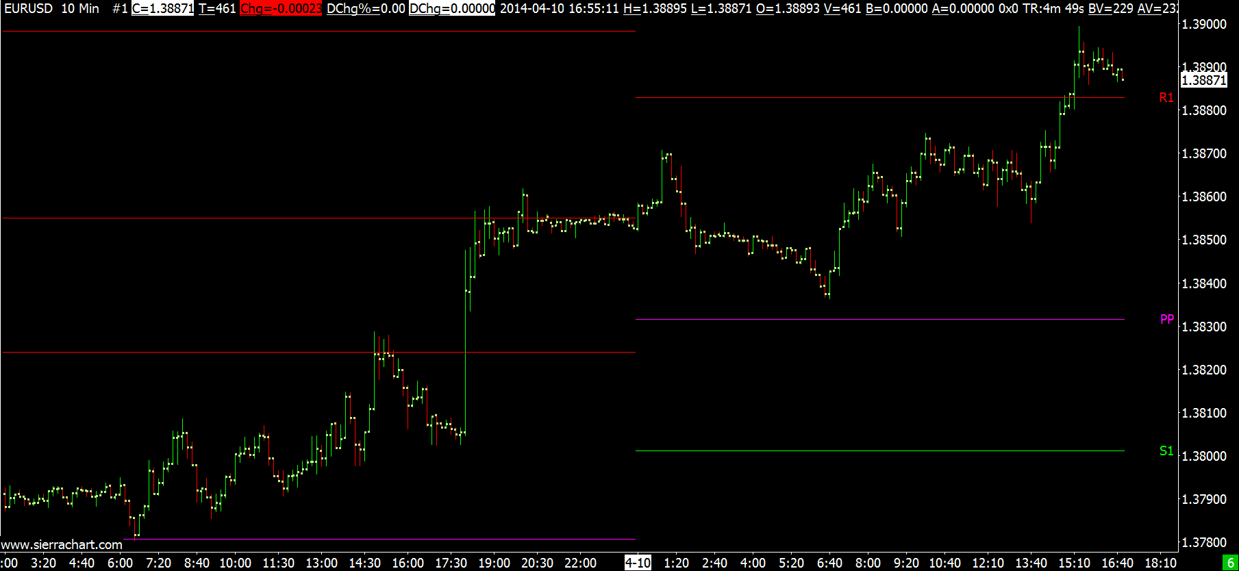

[2014-04-10 13:38:25]
Graham - Posts: 44
Using the Daily OHLC study you can set the line label to align to the right edge.
I'm developing my own study and would like to align the text to the right edge, however the study documentation makes no reference to right edge alignment, only left edge alignment:
http://www.sierrachart.com/index.php?l=doc/doc_ACSIL_Members_scSubgraph.html#scSubgraphLineLabel
When I try to compile with LL_NAME_ALIGN_RIGHT_EDGE it fails. Can this option be added to the Line label functionality from a coding perspective?
imageStudy.png / V - Attached On 2014-04-10 13:37:28 UTC - Size: 59.21 KB - 595 views

[2014-04-10 18:38:58]
Graham - Posts: 44
tried that and the result is the text gets moved literally right over, see image. However if I change the setting manually (as the image in the previous post it reverts to the right edge.
I realise i can change the setting manually but I'm trying to code as much of the settings I require as possible.
imageScreen Shot 2014-04-10 at 19.35.14.png / V - Attached On 2014-04-10 18:37:39 UTC - Size: 23.02 KB - 666 views

[2014-04-10 19:05:34]
We misread the first post. We thought you were asking about the Value label.
We still do not see a problem. We tested using LL_DISPLAY_NAME | LL_NAME_ALIGN_FAR_RIGHT | LL_NAME_ALIGN_CENTER; :
http://www.sierrachart.com/image.php?l=1397156676260.png
There is no problem. Make sure the code compiles properly and make sure you are using the updated DLL file and adding the correct study to the chart.
Date Time Of Last Edit: 2014-04-10 21:27:24
[2014-04-10 20:54:22]
Graham - Posts: 44
I deleted all references to the alignment and recompiled. Then re-added them, recompiled and now it's working fine.
Thanks for your help.
