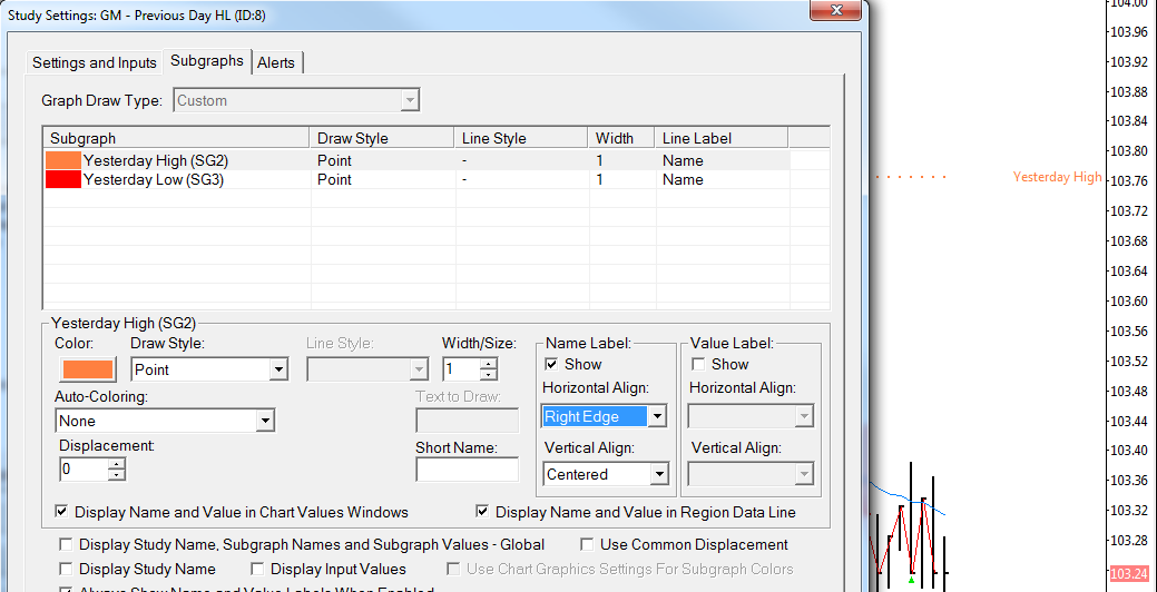

Using the Daily OHLC study you can set the line label to align to the right edge.
I'm developing my own study and would like to align the text to the right edge, however the study documentation makes no reference to right edge alignment, only left edge alignment:
http://www.sierrachart.com/index.php?l=doc/doc_ACSIL_Members_scSubgraph.html#scSubgraphLineLabel
When I try to compile with LL_NAME_ALIGN_RIGHT_EDGE it fails. Can this option be added to the Line label functionality from a coding perspective?
imageStudy.png / V - Attached On 2014-04-10 13:37:28 UTC - Size: 59.21 KB - 595 views
