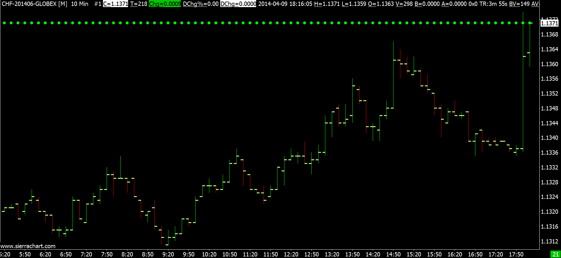

Increase the Number of Bars to Display On study Input with that study. There is also another Input with that study to forward project it.
Furthermore, if I change the Line Style to "Dash" or "Dot" and change at the same time the Width/Size to values bigger than "1", then all Line styles are displayed in a solid way. How can I display e.g. a dashed price line, if the Width/Size ist set to values bigger than "1"?
This is because it is actually not drawn as a continuous line and when the bar spacing is low you will get this kind of effect. Use the Point Draw Style instead:
http://www.sierrachart.com/image.php?l=1397067693886.png

Thank you that all helps and works fine
