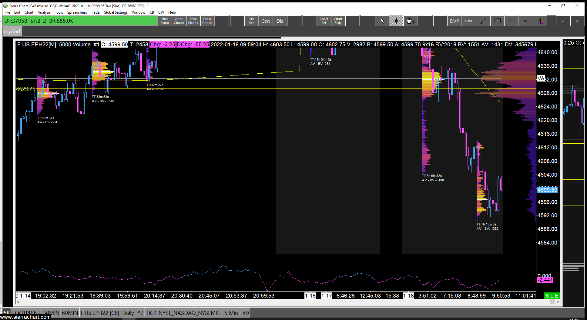

My control bar and message log are way too zoomed in for my screens and I cant find how to change them:
https://www.sierrachart.com/image.php?Image=1642499946561.png
I changed the all the fonts back to default and that fixed a lot of it but the chart borders and chart drawing size is far to big

[2022-01-18 16:37:03]
John - SC Support - Posts: 48591
The border of a chart is defined by the operating system.
We are not sure what you are referring to with regards to the "chart drawing size is far to big". Can you give us more information on what you mean by this?

User758499 - Posts: 10
Can you see in the image provided that the borders and control bar looked ridiculously zoomed in, The resources you provided have fixed many of the issues I had. However, I think the problem is stemming from a the config files that I have copied over from one machine to another could this possibly have to do with the overall scale of sierra chart?
And is there a way that your aware of that can fix the border issue

[2022-01-20 15:00:01]
Window border width is controlled at the operating system level. There is no setting anywhere in Sierra Chart to control this.
And the size of the control bar, relates to the size of the fonts used with the control bar.

[2022-01-21 11:54:59]
Is it possible by saving the config from another machine it messed up my border settings because i have never had this issue until now

[2022-01-21 14:52:13]
No.
