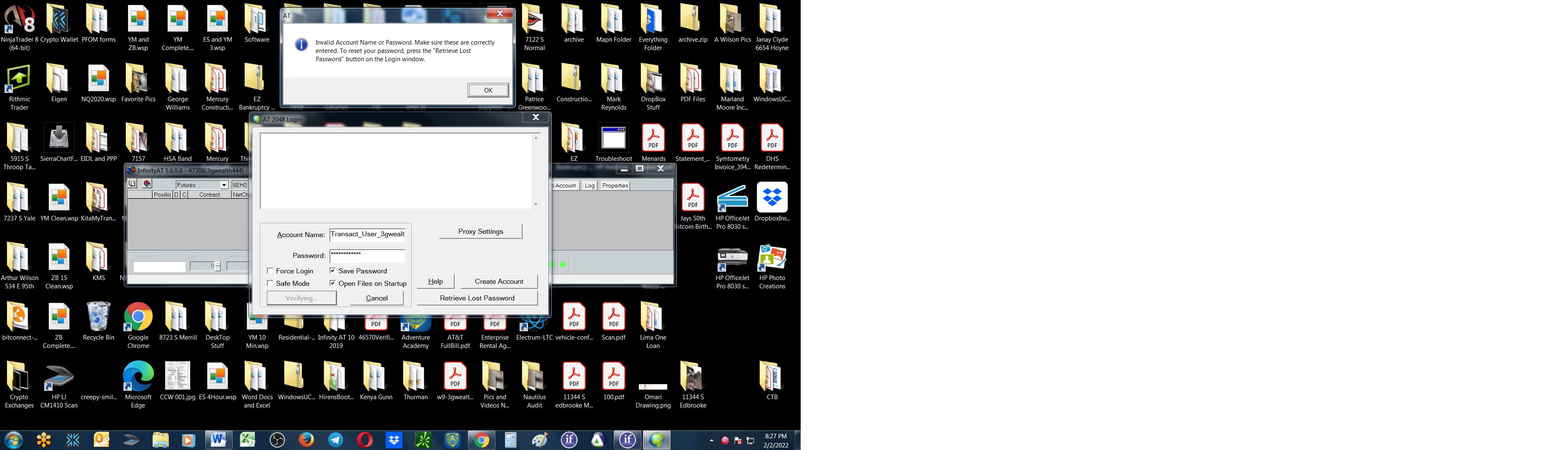

[2022-02-03 02:50:35]
User415649 - Posts: 9
I've tried logging into my secondary PC using the same UN and PW as my main PC, but it's not working. Thanks

[2022-02-03 04:07:46]
Regarding post #5, we can reset your password and send it to your email address. Make sure your email address is updated here:
https://www.sierrachart.com/UserControlPanel.php?page=ManageAccountInfo
Confirm when that is done.

[2022-02-03 04:50:56]
We have reset your Sierra Chart charting and trading software password. It has been sent in a separate e-mail to your e-mail address.
If you did not receive it, let us know. Your e-mail provider may have filtered the message and placed it in a junk mail folder.
