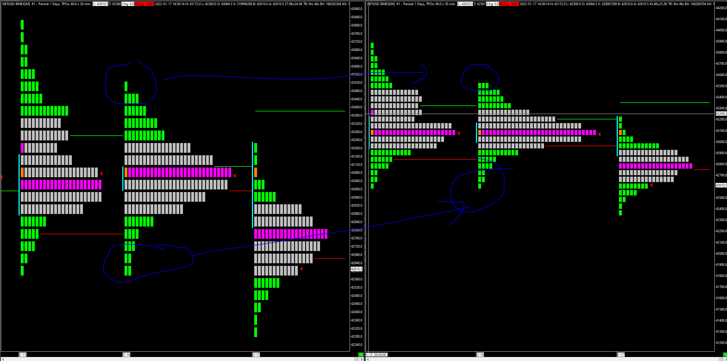

Left: Sierra 2296 version
Right: Sierra 2345 Version
Noticed this this morning after updating to latest version. For some reason the TPO chart is different(price action has different highs/lows on each tpo ). Have not tested in other charts like Numbers bars.

imagebugreport.PNG / V - Attached On 2022-01-17 14:52:49 UTC - Size: 112.23 KB - 281 views

This is a crypto currency symbol from BitMex. There could be inconsistencies with this data between servers due to the behavior of these types of data feeds from the source.
Try re-downloading the Intraday data from before the difference:
Data Errors or Spikes in Charts, Flat or Flat Line Graph, Compressed Graph, Errors with Date/Time Values: 2.1.2 Deleting and Re-downloading Data. (Easier and Recommended Method)
See if you get different high/low data for this symbol after re-downloading the data one or two times.

It didnt fix it. Problem persists allready tried 3 times. 2296 Version works as intended and its also fresh installed so was the newest one. I am going back to the old version that works but the bug is easily recreatible. You just open XBT symbol TPO with ticks above 50 where its visible and the data is completely different from the 2296 version wich i have also tested with other services like exocharts.

We need to understand the difference better. You need to remove the TPO Profile Chart study from the chart and then look at the chart bars themselves and then let us know specifically what the difference is. Or maybe there is no difference with the underlying bars. And just with the TPO Profile Chart itself.
And we really do not think there is any problem in the newer versions of Sierra Chart in this regard. This would not make sense.

There is no difference in candlesticks charts or the bars themselves. The problem only exists on TPO Charts. If you want me to provide more screenshots i will.
