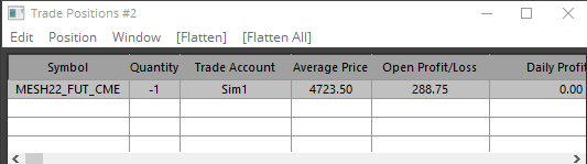

I am not able to close opened position on a SIM acc in the 2-nd instance.
1st instance has no opened sim/live trades and is ok.
Deleted all the catalogue SierraChartInstance_2.
Opened again new instance from the main instance and opened position still exists and working.
How to manage this?
Image attached.
Pls advise.
Thank you

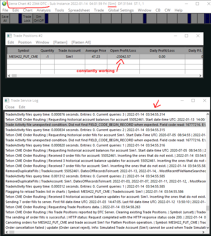

User156295 - Posts: 105
Not solved.
Updated to the latest current version 2344 and still shows opened position, trying to close but impossible.
Image attached.
Also Trade Service log shows I think smth unusual - marked on attached img.
Pls advise
Thank you
image2022-01-14-.png / V - Attached On 2022-01-14 09:04:21 UTC - Size: 68.16 KB - 313 views
[2022-01-14 18:26:25]
Sierra_Chart Engineering - Posts: 25397
Easiest thing to do now is to exit from the sub instance and delete the TradePositions.data file in the sub instance folder.

2-nd instance always has the following first ServiceLog line
"Trade Activity file unexpected condition. Did not find FIELD_CODE_BEGIN_RECORD when expected. Field code read: 16777216. E:\SierraChart\SierraChartInstance_2\TradeActivityLogs\TradeActivityLog_2022-01-13_UTC.Sim1.data | 2022-01-15 03:59:30.610 *"
What can we do else to solve this?
Date Time Of Last Edit: 2022-01-15 09:08:00
[2022-01-16 03:46:10]
This is not a Position. This is a file error with the Trade Activity Log. You will need to delete this data file to remove that error:

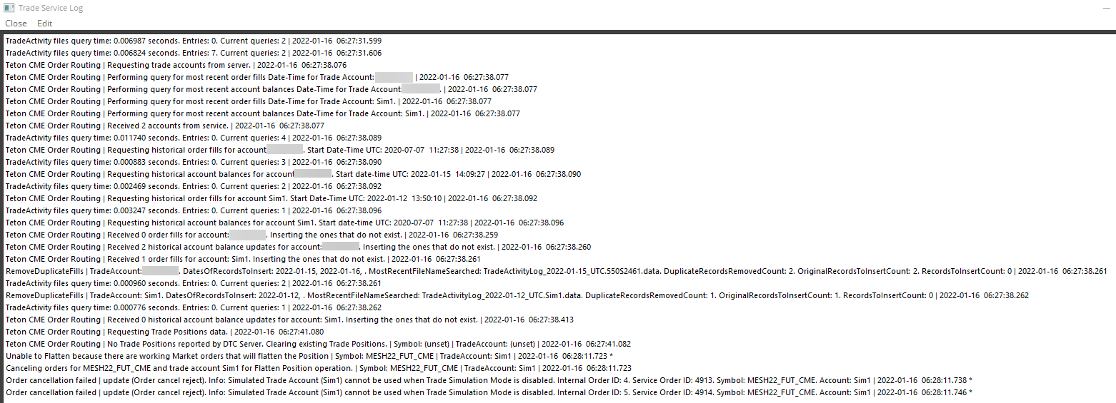

Pls find attached ServiceLog scan - can you read from there what should be done to close non-stop working position on sim at 2-nd instance?
image2022-01-16.png / V - Attached On 2022-01-16 11:35:33 UTC - Size: 78.29 KB - 304 views
[2022-01-16 14:22:38]
This does not make sense. If you have deleted the TradePositions.data file from both instances when they are not running and you start Sierra Chart again, all of the positions listed in Trade >> Trade Positions Window will be gone. They will not be there.

Did you look at attachement from #9 from ServiceLog?
Is there smth unusual?
image2022-01-16-02.png / V - Attached On 2022-01-16 15:18:49 UTC - Size: 6.55 KB - 346 views
[2022-01-17 04:04:26]
This position will automatically clear if the quantity is 0.
No.

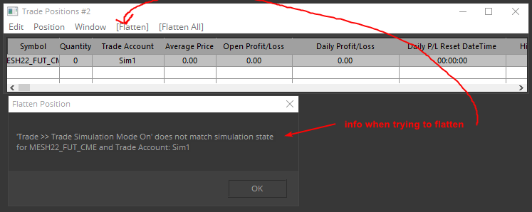

After having the main instance on SIM mode, opened 2-nd instance and checked if it was also on SIM mode and after trying to flatten there is a system announcement as in attached file.
Pls advise how to manage it.
You need to disable Trade Simulation Mode in the sub instance. This will avoid that particular error.

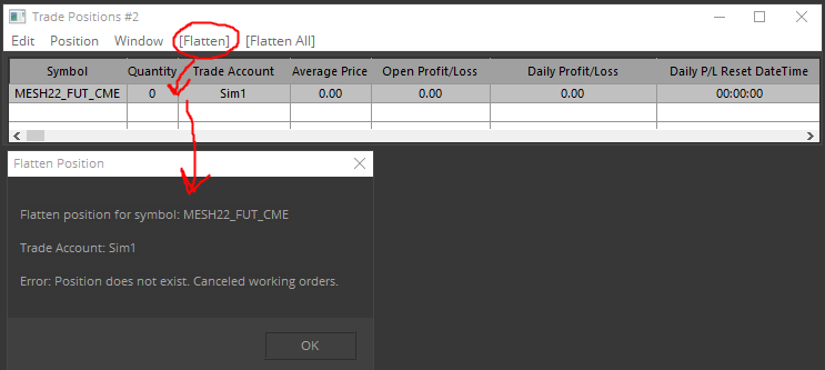

So I put everything on Live mode and the problem still exists - SC error, pls see attachement.
