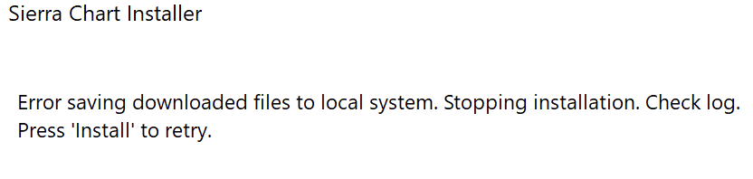

User898094 or Support
Downloaded and installed Parallels 17 Windows 11 ARM. But SC isn't installing.
Did you do anything other than follow the installation prompts for the current version of SC?
I am getting this in the Log file:
Failed to create folder: SierraChart\DownloadedInstallationFiles\ACS_Source\. Windows error code 3: The system cannot find the path specified. | 2022-01-04 17:44:15
[2022-01-04 18:33:20]
macguerra - Posts: 20
File attached Showing Error Message
Date Time Of Last Edit: 2022-01-04 18:34:22
imageScreen Shot 2022-01-04 at 1.32.02 PM.png / V - Attached On 2022-01-04 18:32:31 UTC - Size: 16.65 KB - 647 views
[2022-01-04 18:42:09]
UPDATE: I specified the recommended path C:SierraChart and I got SC to install and load.
I needed to create the folder first, as the installer didn't create the path by default, due to the virtual machine file nesting protocols, I suppose.
