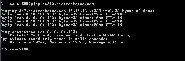

[2014-04-07 05:27:37]
Tonkadad - Posts: 235
I can ping it.
imageping.PNG / V - Attached On 2014-04-07 05:27:28 UTC - Size: 10.87 KB - 676 views

[2014-04-07 05:33:58]
OK sounds like a possibly a firewall problem.
Are you running any firewall software on the computer? The Windows firewall should not be a problem
