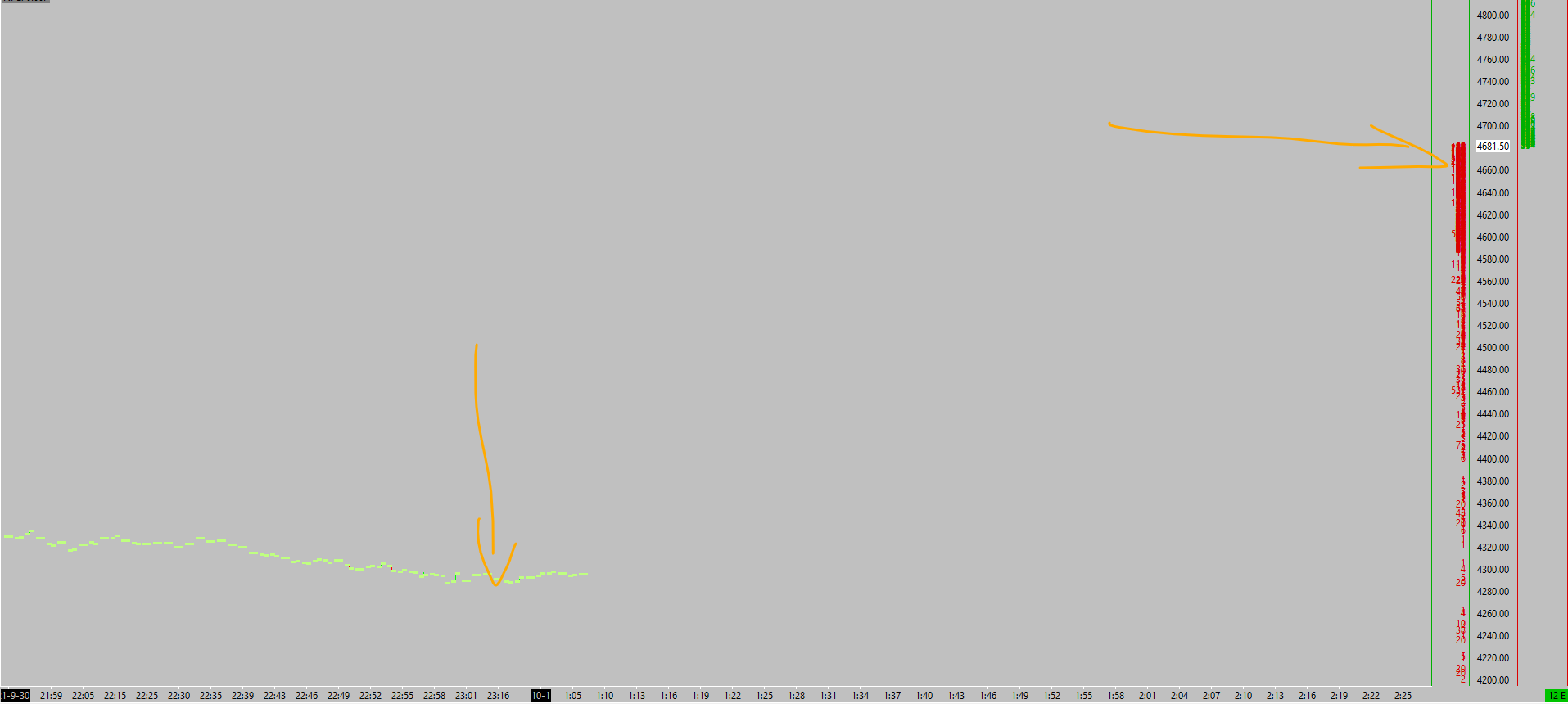

i also currently have an eval account with Topstep and was availed Rithmic Credentials , and it connected perfectly , BUT my charts arent rendering in real time and its only the DOM thats working at present in real time , so am confused at to why my charts or footprints or heatmaps arent loading in real time ?

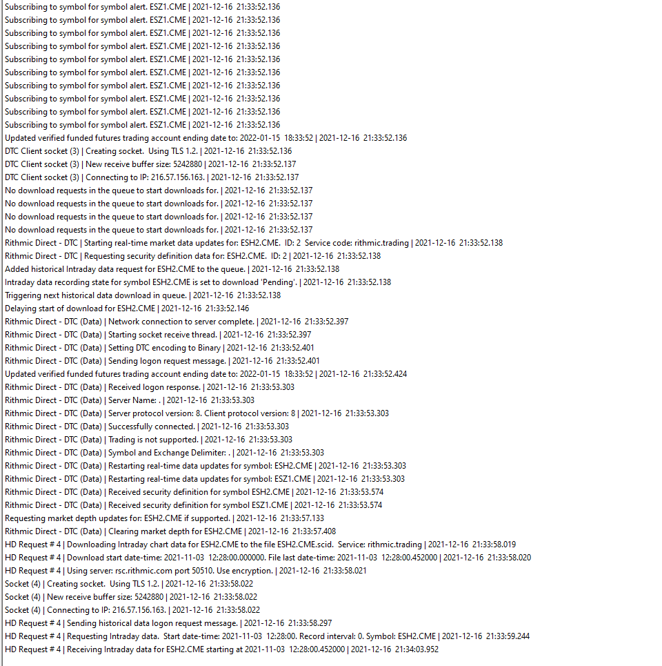

User868766 - Posts: 11
File attached
have attached both images for the chart info not rendering viz a viz DOM real time going on as well as message log
beacuase i also dont get the Blue BOX that normal shows "historical data download .Bars may not appear until done even."

[2021-12-16 19:28:29]
John - SC Support - Posts: 48388
First, what is the symbol of the chart for which you supplied the image?
Second, what are the Chart Settings for that chart, in particular the settings related to the days that are displayed?
Third, do you have a Trade and Current Quote Symbol set for that chart and if so, what is it set to? Is the option "Use as Trade Only Symbol" enabled or not?
[2021-12-16 19:38:50]
FIRST , am using ESH2.CME (for rithmic and also did translate symbol to data service ) aswell
SECOND, as far back as 10 days max for me
THRIRD, trade and current Quote Symbol is N/A not active
I decided to reset and start a fresh my Sierra chart and when i setup rithmic it works very welluntil when i disconnect and when it starts to download , the historical data wont download and the Trading DOM will continue chugging in real time while the Charts arent rendering in real time similar to the DOM
Date Time Of Last Edit: 2021-12-16 20:02:44
[2021-12-16 21:47:18]
The reason for what you are seeing with the "fresh" instance is due to a lack of historical data from Rithmic. Refer to the following information:
Historical Data on the New Rithmic Connection
