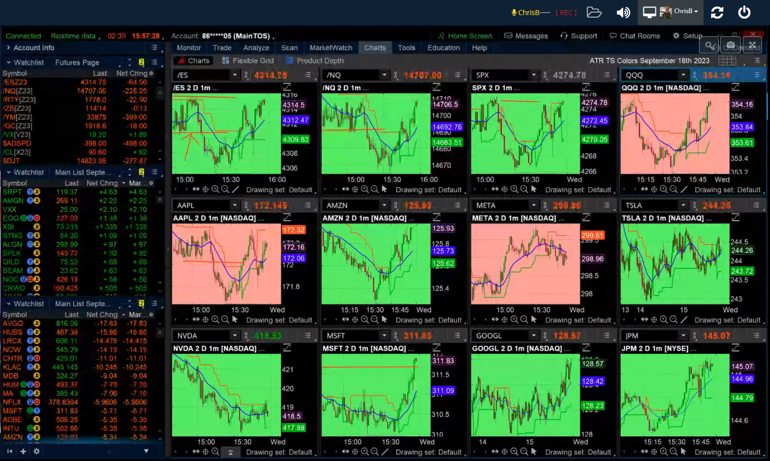

I'm looking for something similiar, but still a bit different. Is there a tool, way or indicator which colors the background red or green, depending on the price of theprevious bars (for example 3 out of 5 bars were higher --> therefore green backgound, or current close price was higher than last bar, green background)
It all should look somehow like the attached image to give a quick overview of the price movements of the charts.

User693923 - Posts: 5
Here's the screenshot.
imagemonitor_charts.png / V - Attached On 2023-09-27 10:15:24 UTC - Size: 1.68 MB - 296 views
[2023-09-27 15:06:11]
There is not a way to do this with the built-in studies in Sierra Chart. It can be done by creating a custom study.

[2023-09-27 16:36:09]
Sawtooth - Posts: 4361
You can do it with the Spreadsheet Study study, with this limitation:
The spreadsheet study only continually updates the most recent 10 bars.
If this limitation is acceptable, and you want details how to do it, post again.
Date Time Of Last Edit: 2023-09-27 23:35:08
thanks for getting back to me! Yes, sure. It would be great to get further info about how to do it. The limitation is totally acceptable.
Many thanks!
[2023-09-29 14:49:49]
Put both the attached files in your Sierra Chart \Data folder.
Apply the Study Collection to your chart, and choose No when asked 'Clear Existing Studies On Chart?'.
Analysis >> 10bar background coloring+
Note: You must have both files in the \Data folder so that the proper settings are applied.
For an understanding of how this works, notice Spreadsheet Study study's settings.
The formula in cell K3 on Sheet1 can be edited as needed. Currently it is comparing the current Close with the previous Close.
Row 3 is the current bar; previous bars are in rows below.
You must use an absolute reference ($) so that all 10 bars color together.
The final 'else' of the IF statements must reference K4.
When you apply this Study Collection to more than one chart in the same chartbook, each chart will have its own Sheet# matching its chart#, but the formula in K3 on Sheet1 will affect all charts/sheets equally.
If you want unique formulas for each chart, set the Formula Source Sheet Number setting to match its chart#, and edit K3 on its respective sheet#.
