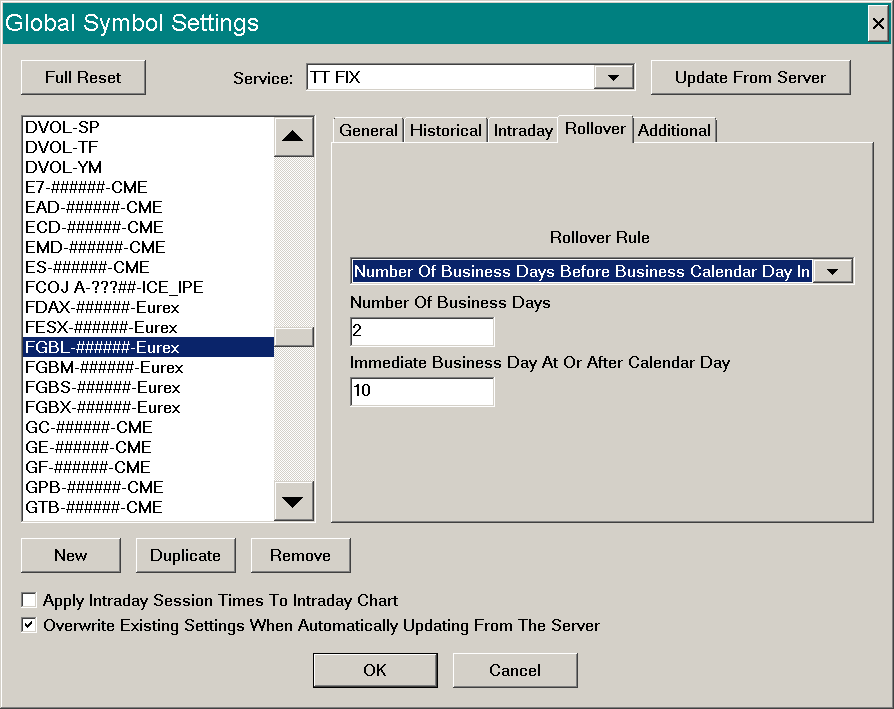

This can be done through the Rollover tab for the symbol in the Global Symbol Settings:
https://www.sierrachart.com/index.php?l=doc/doc_GlobalSettingsMenu.html
See attachment for the recommended settings.
imageBund rollover settings.png / V - Attached On 2014-04-04 18:38:39 UTC - Size: 14.64 KB - 736 views
[2014-04-04 20:23:05]
Bango - Posts: 76
Applying the recommended settings Eurex charts are not consistent with continuous back adjusted IQfeed's.
Where's the fault?
Thanks again.
[2014-04-04 21:31:01]
You can change the settings to match what IQ Feed uses . You will need to find out what they use.
