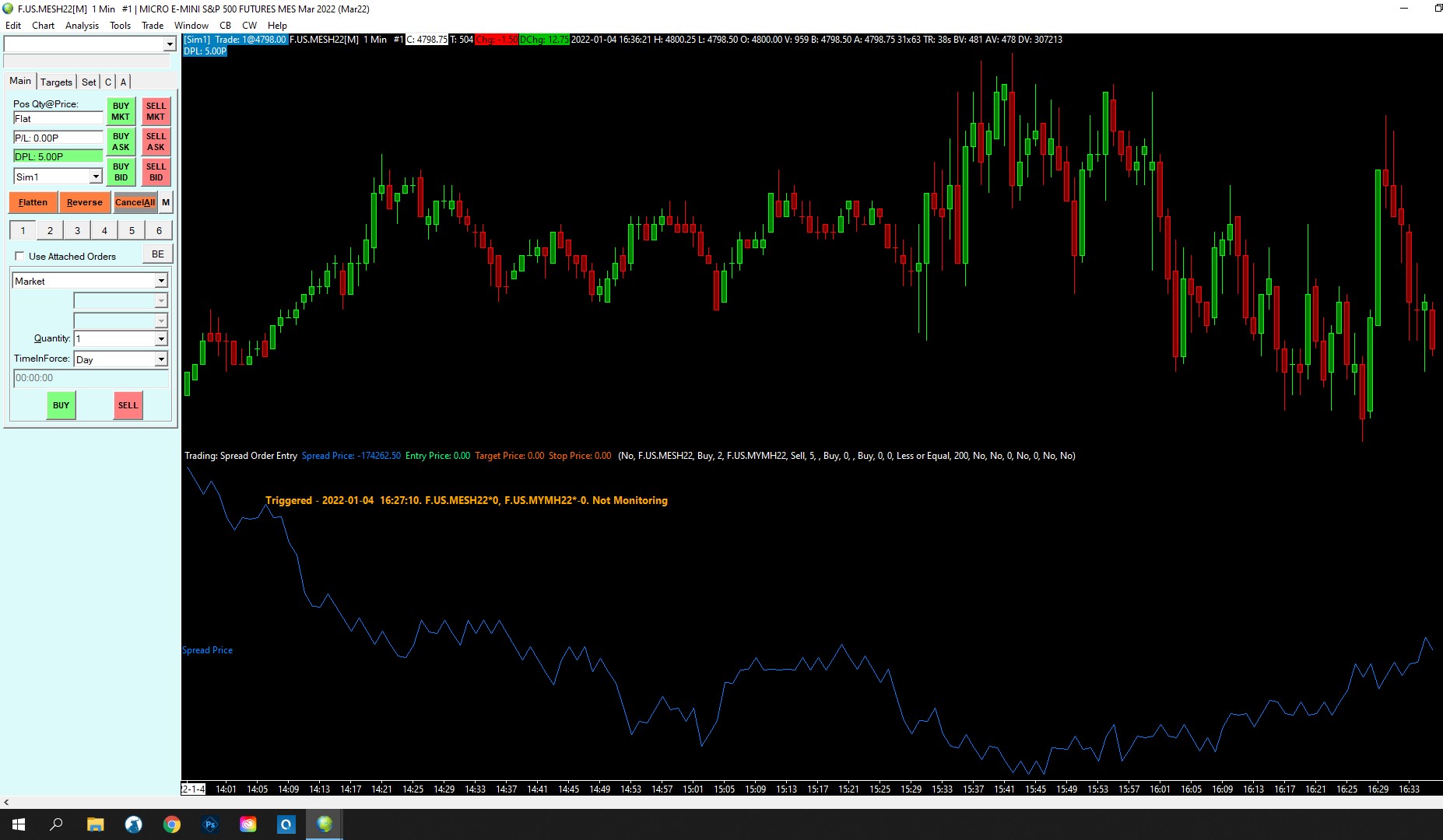

Okay, thanks for the info! What do I have to change at AMP if I order the Sierrachart Trade Routing?
Another small problem with my spread experiment: The chart only shows leg 1.
P/L also only shows the changes in leg 1 and not the spread itself. What do I have to do to see the spread itself?
First, you should check and see if there is an exchange-traded spread already in existence for what you want to do. If so, then you can just trade that spread and not have to deal with setting everything up within Sierra Chart. Refer to the following:
Real-Time Exchange Data Feeds Available From Sierra Chart: Exchange Traded Spreads
Otherwise, you would need to use the Spread Order Entry Study, which it looks like you found. But refer to the instructions for this at the following link and make sure everything is setup properly:
