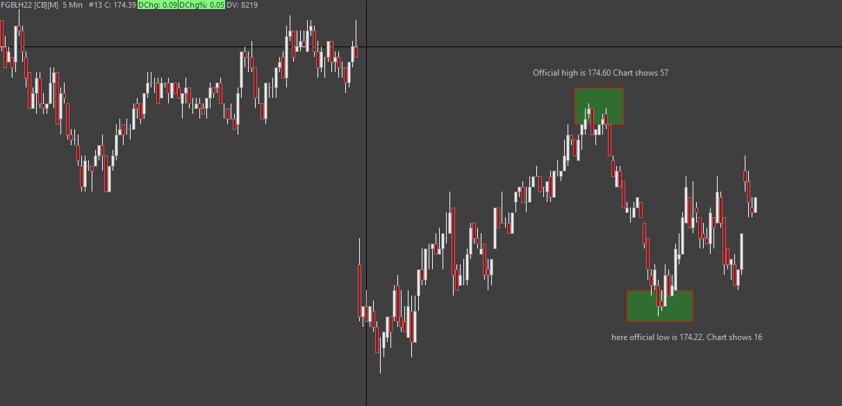

Hello sc support,
I have the same problem, with a 6 tick difference. I Tried to solve this since yesterday and can't find any solution. Each rollover period it's a mess.
[2021-12-08 07:23:19]
Eighteen_0_Six - Posts: 21
Attached the chart exemple :
https://www.sierrachart.com/Download.php?Folder=SupportBoard&download=57927
imageCapture.PNG / V - Attached On 2021-12-08 07:21:26 UTC - Size: 30.37 KB - 310 views

I changDd in the specifiaction product the nbre of day before the roll over....
chart setting> edit global symbol setting> custom roll over method set to 3 business day before....
Let me know if it works for you then..
