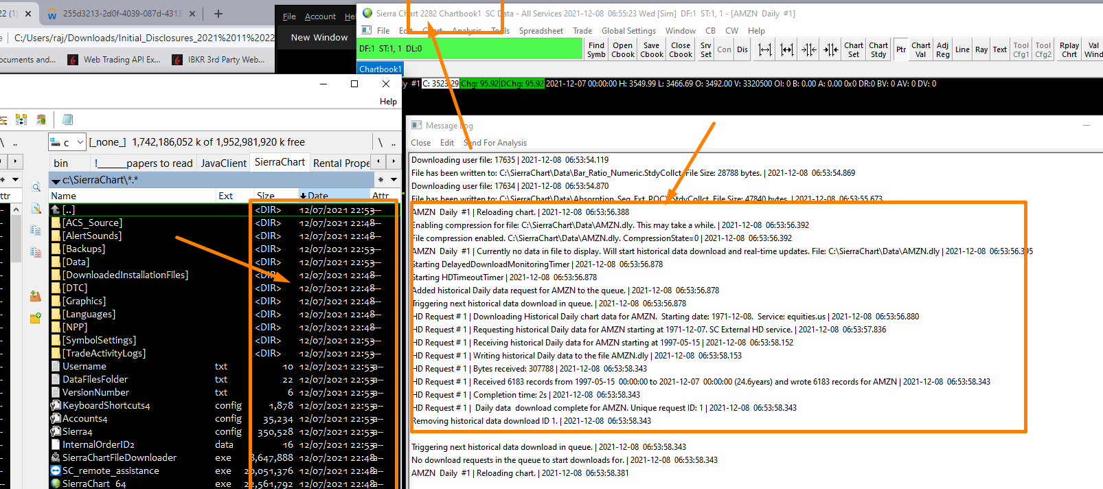

[2021-12-08 06:57:55]
ephi144 - Posts: 57
here is a fresh install of 2282.
no changes - to any thing - all as it is
and works just fine with IBKR.
2300+ have issues. i hope SC acknowledges and helps fix it.
Date Time Of Last Edit: 2021-12-08 06:58:14
imageSC_2282_IBKR_WORKS.png / V - Attached On 2021-12-08 06:58:11 UTC - Size: 168.39 KB - 308 views

[2021-12-08 18:42:02]
ephi144 - Posts: 57
would you please do us a favor and give us a walk through on how to solve this?
i have tried symbol setting and added USD as currency. Also tried modifying the custom symbol xml but not working. I have provided those screen shots.
even if you can just share the correct xml sample for stock (aapl for example) and future (ES for example) we would really appreciate it.
EDIT - i have the same exact problem as above user.
Date Time Of Last Edit: 2021-12-08 18:42:42
[2021-12-08 20:04:06]
GravisHTG - Posts: 321
I use IB all the time here. I am trading equity and equity options directly from SC.
I can had that i pay to get the data feed from SC ( its way faster and more reliable )
So, What I do to get rid of most of the bugs, when I have some, Is to kill ( delete ) my subinstance and reload it.
As I never use the main instance for anything ( its the main download node for all sub )
And like that , each time I had some bugs, It got fixed.
maybe it will help on your side.
Date Time Of Last Edit: 2021-12-08 20:16:59
[2021-12-08 20:14:42]
ephi144 - Posts: 57
thank you @GravisHTG
by any chance do you see issues with getting stocks data with similar issues? if so how did you resolve them?
I will use your approach you have described above - however i still cant get some of the NQ data (e.g. above errors) with newer versions of SC.
I am using 2282 with success.
[2021-12-08 20:18:53]
I just edit the top post,
I use SC feed , but All data is there for sure , you need to make sure you have the right symbol too... ( But I remember , IB data feed is very bad and slow. And its not only on SC , I tried it on NT8 and its even worst , Minute and daily is the minimun you can got with IB feed on NT8 )
I only use IB data feed for options now as , SC does not have any feed for it. ( and I try to put it to 1 day of pulling data only , and even sometimes its very slow and I never get historical intraday data )
For future , I got denali data for 4$ a month , no level 2. but very reliable
The program is very picky
like for an option , I have to write
SPY-OPT-20211203-453-P-SMART-100-USD
For Future contract like NQ and ES , i use the
NQ-202112-GLOBEX
but I find that symbol by going in the F5 menu of the chart and find under symbol
Date Time Of Last Edit: 2021-12-08 20:31:57
