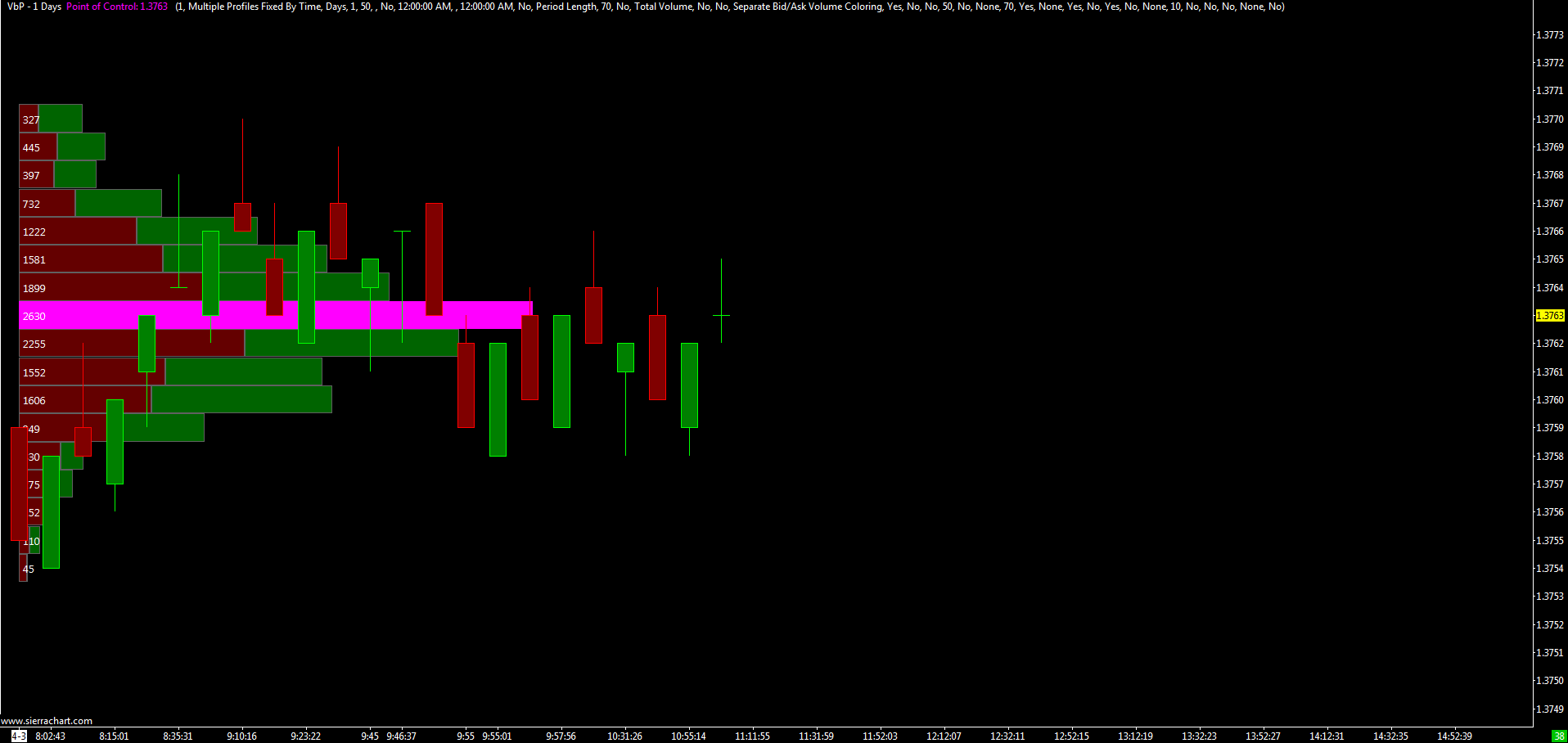

[2014-04-03 07:44:41]
We do not see a problem with this:
http://www.sierrachart.com/image.php?l=1396511066702.png

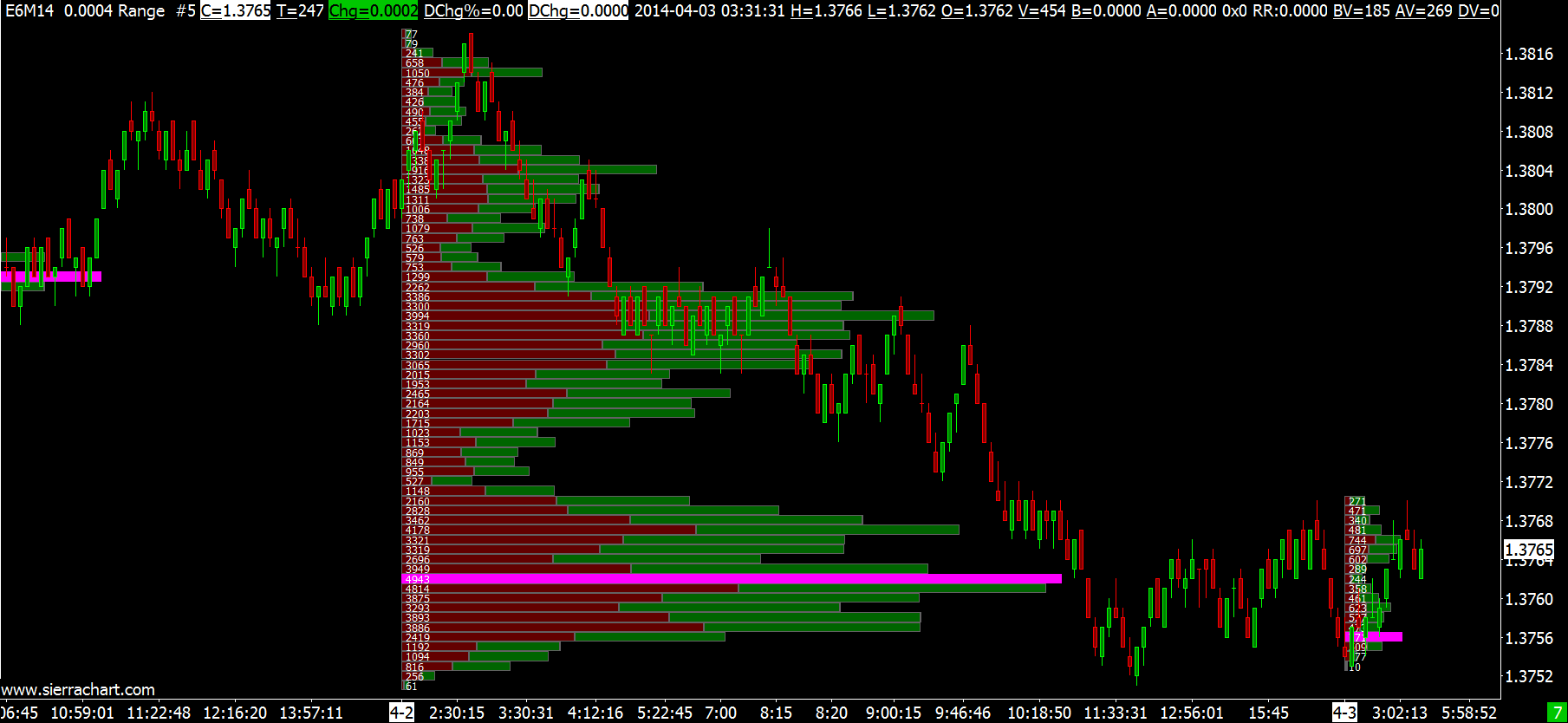

[2014-04-03 09:11:19]
User38215 - Posts: 14
See attached volume on POC for example. Should be 3127 as I type this.
image6EM4-CME 0.0004 Range #5 41732.383.png / V - Attached On 2014-04-03 09:10:54 UTC - Size: 72.37 KB - 692 views

[2014-04-07 17:04:17]
This is getting confusing, because post #9 is from a different account. Is that you?
Also in the chart given in post #9 it appears like the Intraday Session Start Time starts around 08:00:00 in Chart >> Chart Settings. So this is going to be the reason why the Volume Profile starts at that time.

[2014-04-08 07:54:28]
It is possible we are being deceived by the Range bars and the market trading within a tight range over an extended period of time.
Make sure you have Chart >> Chart Settings >> New Bar at Session Start enabled.
If it is, then set the chart to 1 minute per bar. Do you see data from midnight to 08:00.
In the most recent image you posted, it looks as though the data is not there. This is the problem with range bars. It is hard to definitively tell.
[2014-04-08 08:15:18]
Dom7364 - Posts: 258
Ok. I am getting correct volumes by adding "Use evening session" and "new bar at session start" (the latter was checked but not the "use evening session". Works fine it seems with Range or minutes etc.
