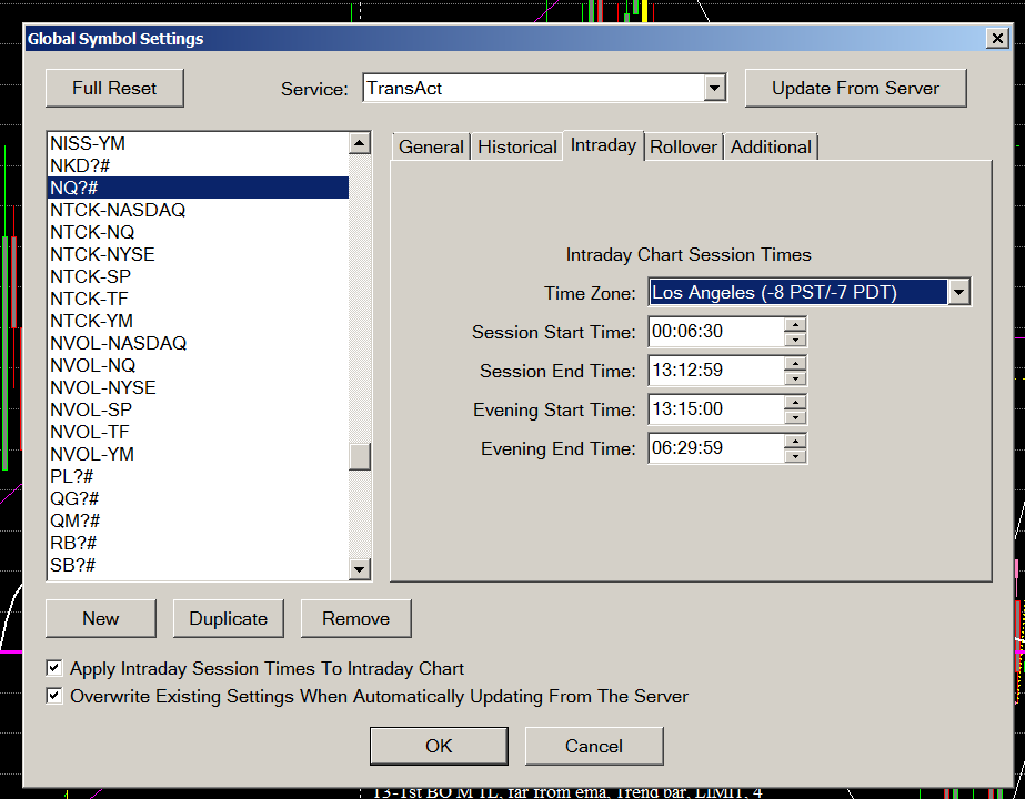

I have set NQ$# intraday settings to be RTH when I am on the west coast of Canada (LA time zone) - see first attachment

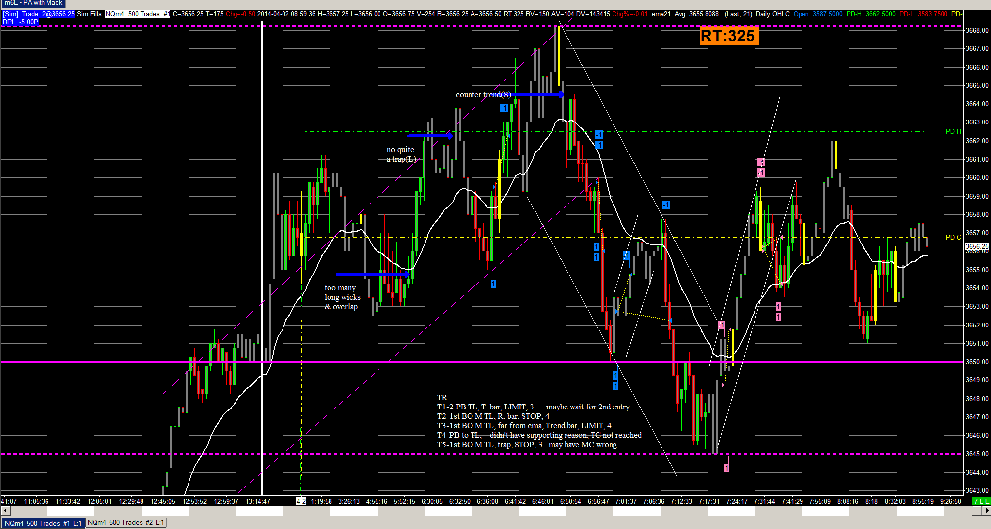

I have included Daily OHLC in my study and you can see it us using midnight for my intraday start time - see 2nd attachment.
image2014-04-02_sym-settings.png / V - Attached On 2014-04-02 16:03:29 UTC - Size: 55.76 KB - 509 views
image2014-04-02_Sym-settings2.png / V - Attached On 2014-04-02 16:03:57 UTC - Size: 103.87 KB - 582 views
[2014-04-02 16:42:16]
This is not the correct way to do this. Refer to the Daily OHLC documentation here:
https://www.sierrachart.com/index.php?l=doc/doc_TechnicalStudiesReference.html#s137
You need to set the Session Times in Chart >> Chart Settings.
Also in the Symbol Settings image you posted, you have set the Start Time to 6 minutes and 30 seconds past midnight.
