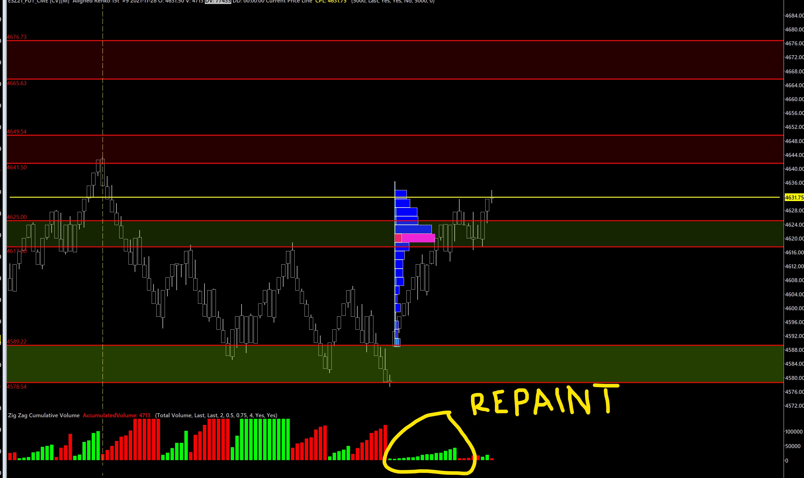

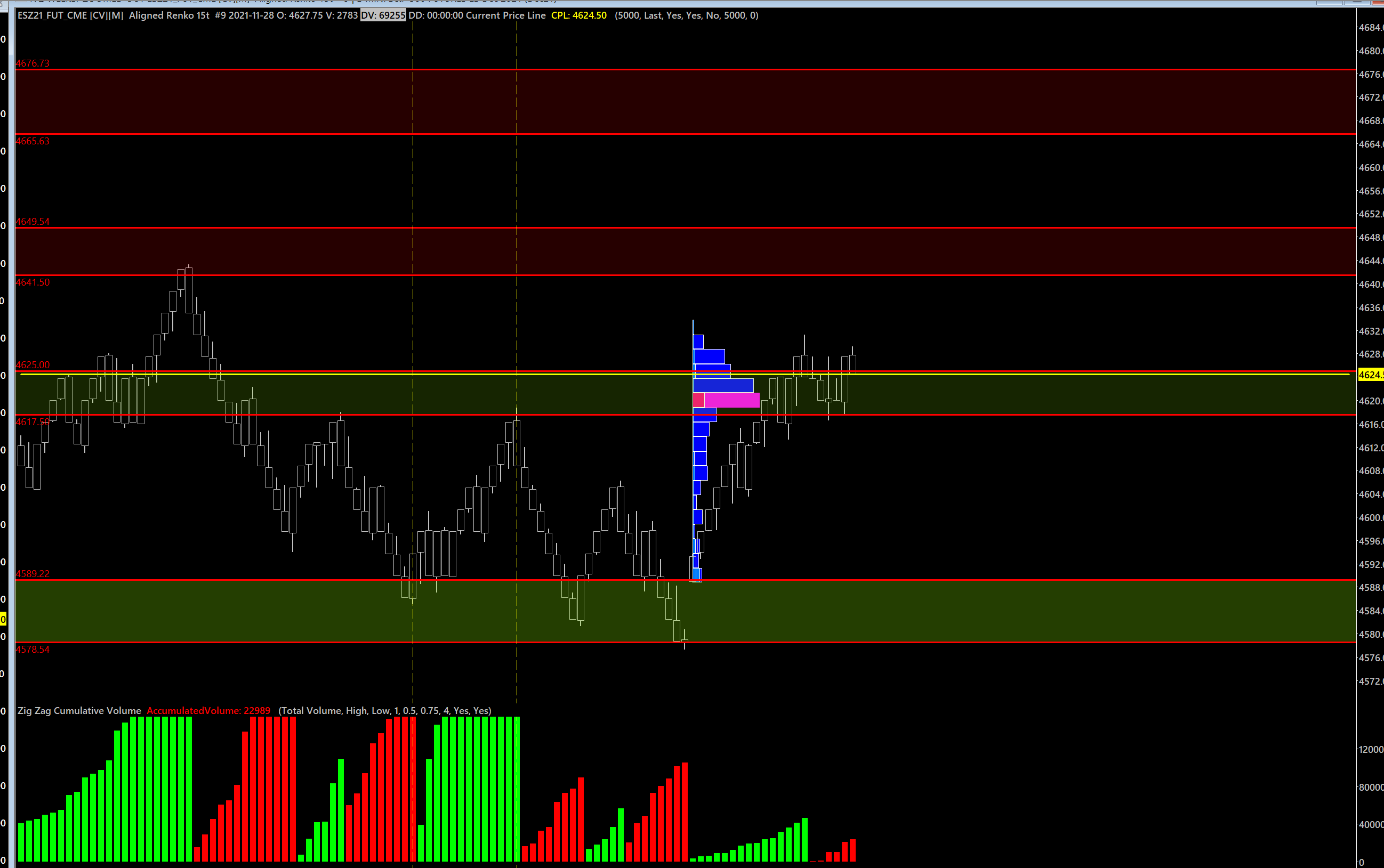

[2021-11-29 00:07:37]
User575399 - Posts: 350
here is what I mean. See how it is off and it will also repaint the previous bars
Date Time Of Last Edit: 2021-11-29 00:19:48
imageScreenshot (249).png / V - Attached On 2021-11-29 00:08:02 UTC - Size: 84.36 KB - 412 views
imageScreenshot (252)_LI.jpg / V - Attached On 2021-11-29 00:19:43 UTC - Size: 1011.37 KB - 399 views
[2021-11-29 08:31:07]
User907968 - Posts: 884
The study configuration is not consistent bewteen the two images, so how can you possibly compare them?
249 is set to 'Total Volume, High, Low, 1, 0.5 0.75, 4, Yes, Yes'
252 is set to 'Total Volume, Last, Last, 2, 0.5 0.75, 4, Yes, Yes'
Also, it is normal to repaint if a reversal starts but is not confirmed, but that is dependant on your configuration.
Using image 249 configuration - a reversal has started, but until price moves 0.5% off of the most recent swing high the reversal is not confirmed. As price does not move the specified distance, the move is not confirmed and the reversal is invalid, ergo the up trend continues and the volume bars are correctly repainted accordingly.
Date Time Of Last Edit: 2021-11-29 08:31:30
