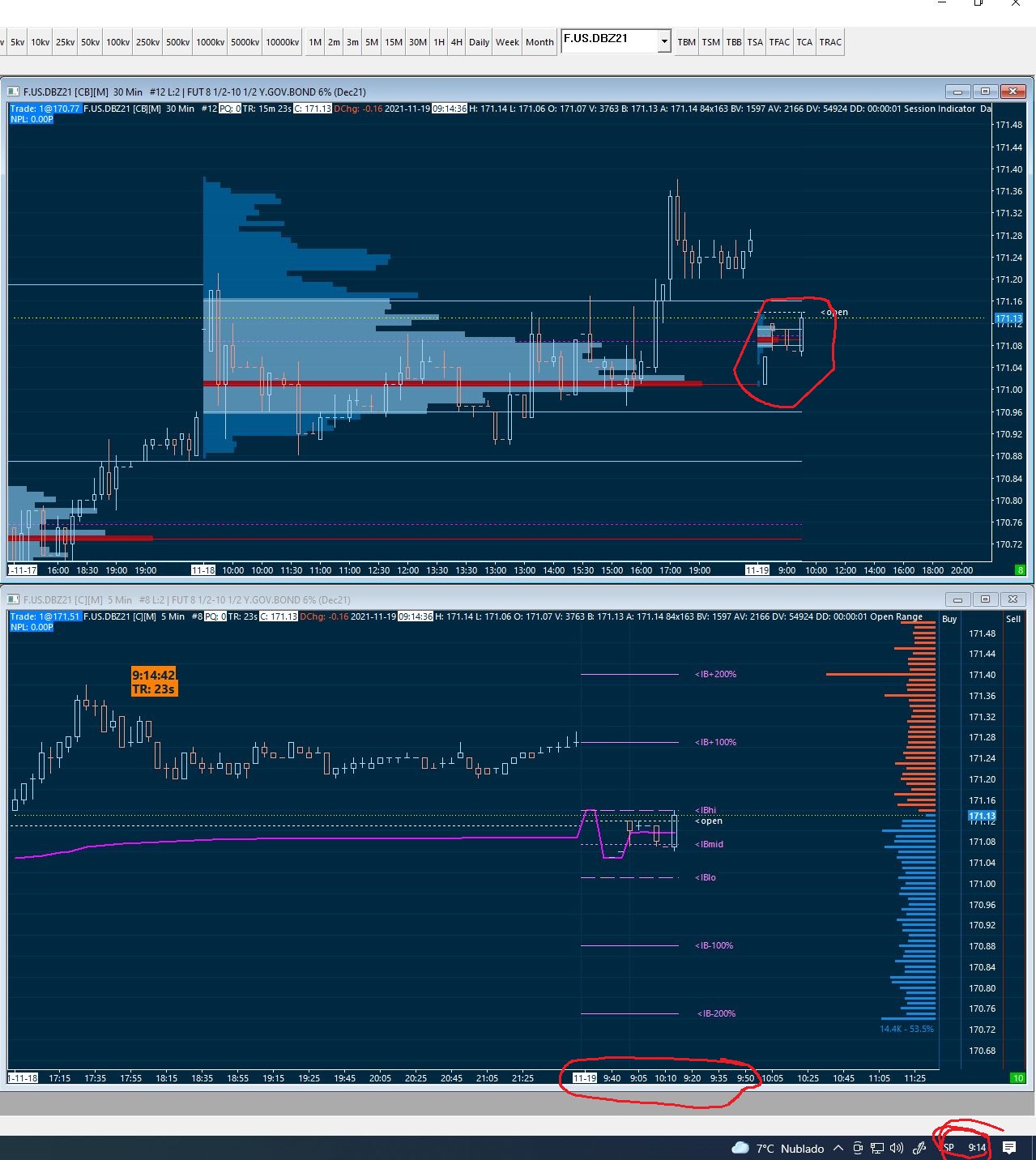

For a while now I have been observing a weird behaviour with the Denali data feed for the Bund. Timestamps do not appear correctly and you get weird charts. I can see the same behaviour regardless of my charts being regular candle charts or TPOs.
I attach images of this morning:
- time was 9:14 as you can see in the first image.
- in image 1, in the regular 5min candle chart there are 9 candles...kindof... => not possible at 9:14 and I dont have have Full Session enabled, and in the 30min chart above there are 5 candles already!!
- timestamps are all mixed => open followed by 9:40, then 9:05, then 10:10, then 9:20....

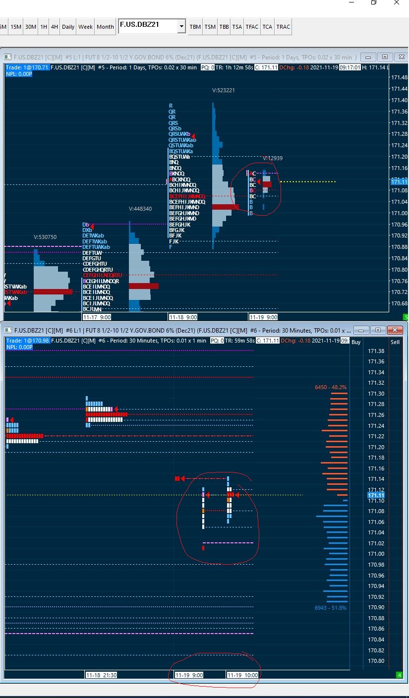

- my 30min TPO chart show that we are in period C (should be A) and my 1min TPO should have 14-16 TPOs but there are 4 and it says that we are pass 10:00
This happens ONLY with the bund, not with other Eurex symbols. I have the Denali datafeed and CQG order routing.
