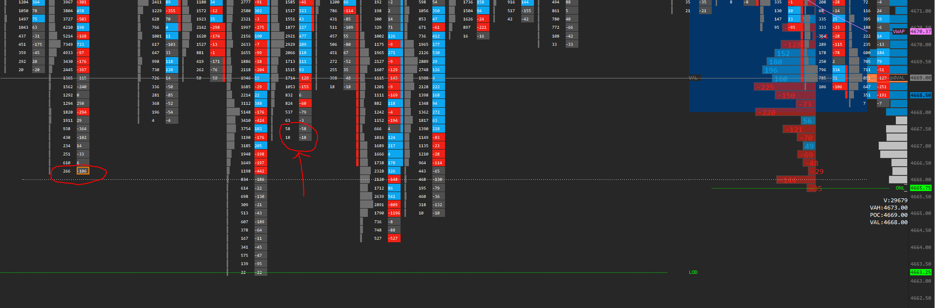

Please take a look at the attached pic. You will see that on the left, I circled where there was a Nonzero BidAsk Volume at the High/Low.
The 2nd circle shows where the BidAsk volume on the last 2 rows of that bar are the same. Is there a way to highlight this? I basically want to identify when we have double zero's at the top/bottom of any bar.

Take a look at this updated screen shot. Column 2 is volume. Column 3 is Ask Vol Bid Vol Difference. In the picture, #1 is basically an unfinished auction; #2 is the double zeros which is what I want to have displayed somehow visually and #3 is where the volume matches the ask/bid vol difference. I've also attached a screenshot of my settings from Number Bar study.

[2021-11-15 23:19:13]
Sawtooth - Posts: 4359
To clarify, is this what you want?:
- mark where the ask vol is 0 at the low and 0 at the low + 1 tick
- mark where the bid vol is 0 at the high and 0 at the high - 1 tick
[2021-11-16 13:32:31]
amazayn - Posts: 48
Yes, this is exactly what I am looking for. How can I do this?
[2021-11-16 18:22:54]
Try this:
1. Add the Color Bar Based On Alert Condition study
- On the Subgraphs tab, set the Draw Style to Point On Low and the Size/Width to 5
- Use this formula on the Alerts tab for double 0 ask vol at low:
=AND(AVAP(L,0)=0,AVAP(L+TICKSIZE,0)=0)
2. Add another Color Bar Based On Alert Condition study
- On the Subgraphs tab, set the Draw Style to Point On High and the Size/Width to 5
- Use this formula on the Alerts tab for double 0 bid vol at high:
=AND(BVAP(H,0)=0,BVAP(H-TICKSIZE,0)=0)
Study/Chart Alerts And Scanning: BVAP

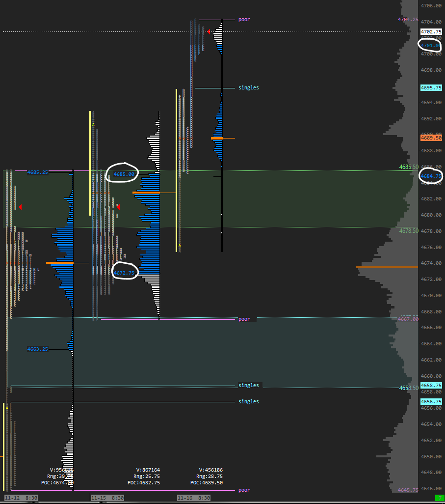

Yes, this looks like it worked. TY for your help. Can I ask you one more question - do you know how to get the Value Area high/low to be displayed as in the attached figure?
imageVA figures on TPO.png / V - Attached On 2021-11-16 20:59:21 UTC - Size: 92.6 KB - 406 views
[2021-11-16 22:43:47]
Sorry, I don't.

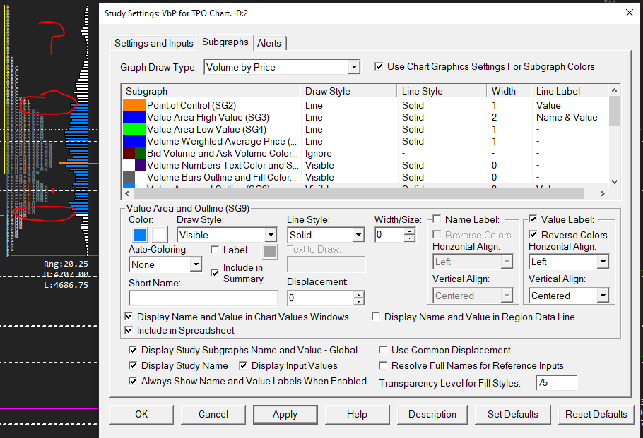

[2021-11-16 23:01:09]
On the Volume by Price study for the subgraph named Value Area and Outline, turn on the Value Label and set the Horizontal Align as you desire (Left works best in this particular case).
Refer to the following for the Value Label information:
Chart Studies: Subgraphs Tab >> Name and Value Labels
Date Time Of Last Edit: 2021-11-16 23:01:48
[2021-11-16 23:15:16]
amazayn - Posts: 48
Yeah I have been trying that but for some reason it isn't working. See screenshot of my settings.
Date Time Of Last Edit: 2021-11-16 23:15:30
imageVA figures on TPO 2.PNG / V - Attached On 2021-11-16 23:15:27 UTC - Size: 65.75 KB - 336 views
[2021-11-17 02:06:00]
amazayn - Posts: 48
I figured it out - the Extend Value Area setting and input had to be set to End of Period.
