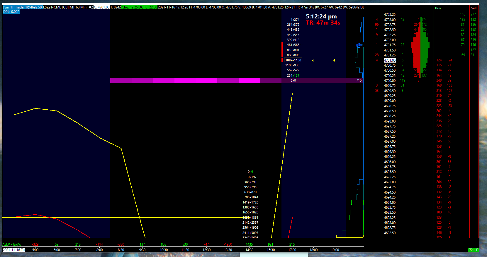

[2021-11-16 20:04:17]
joplacas - Posts: 9
Hi, having troubles with data denali
It doesnt charged data correcly leaving behind unreal gaps...
i attach log if you need it.
but i cannot trade with this. this is the second day it happens...
best
imagegap.PNG / V - Attached On 2021-11-16 17:13:20 UTC - Size: 273.13 KB - 303 views
Private File
[2021-11-16 20:13:08]
First thing we want you to do is to update Sierra Chart:
And make sure the Session Times include the entire 24 hour time range:
Intraday Chart or Chart Bars Not Updating | Blank Intraday Chart | "Currently no data to display" message for Intraday Chart: 3.3 - Session Start Time and End Time not Covering Current Time
