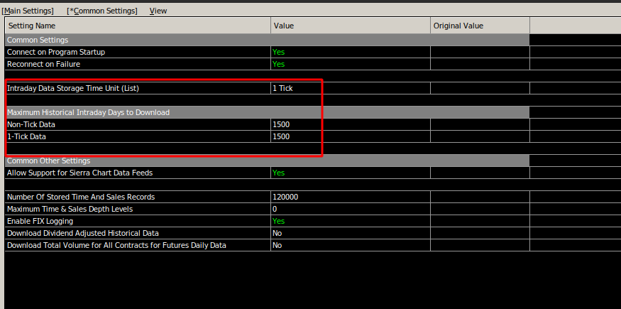

As far as I can tell, I do have the settings correct:
https://www.sierrachart.com/Download.php?Folder=SupportBoard&download=56467

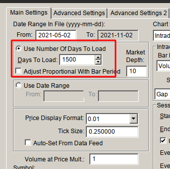

I've also set the chart settings to download the last N days:
https://www.sierrachart.com/Download.php?Folder=SupportBoard&download=56468

The key thing that I think might be relevant is that the day before rollover, the chart is using 30 second bars, the day after rollover it is using volume bars which seems like some setting regarding continuous contracts that I have not divined.
imagehistorical_intraday.png / V - Attached On 2021-11-03 01:14:54 UTC - Size: 33.75 KB - 324 views
imagechart_settings.png / V - Attached On 2021-11-03 01:16:26 UTC - Size: 25.8 KB - 293 views
