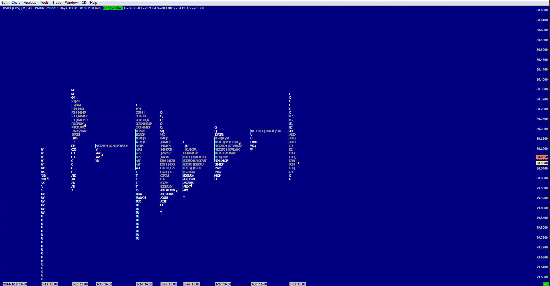

The TPO prints correctly on Friday's trade however when I reconnect to the data feed on Monday's I lose lose Fridays profile. Friday's date also does not show
My timezone is GMT +8hrs, I have the SC real live data feed connected to OEC.
I have included an image of the last 10 trading days for the USDX to highlight how Fridays TPO prints after reconnecting, including the date changes e.g. 3-23; 3-30
imageSC TPO USDX.png / V - Attached On 2014-03-31 12:55:46 UTC - Size: 90.24 KB - 609 views

Remove the TPO Profile Chart study from the chart. Do you see the chart bars for Friday 28th?
[2014-04-01 10:28:46]
BJV - Posts: 29
Looking at the candles and referencing the TPO example above the session time is 16.00.00 - 03.59.59 and I have no data from 3-28 03.59, data kicks back in 3-31 02.20.
When I set the chart session times to 06.00.00 - 05.59.59 I have no data from 3-28 05.59.59 - 03-31 02.20.
I do not understand why I am not getting (or loosing) data from Friday mornings after I reload the chart on Monday's. I am watching the TPO build on Friday evening which indicates the data is there. In the above example I would expect data to load up to 3-29 05.00 in line with the the 6E....thanks
[2014-04-01 17:52:05]
This makes sense since you are filtering out that data with these Session Times.

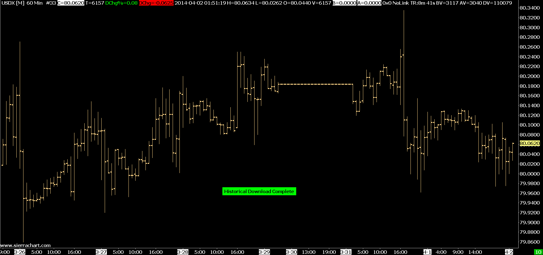

This is the data that we see using a +8 UTC time zone:
http://www.sierrachart.com/image.php?l=1396374681124.png
