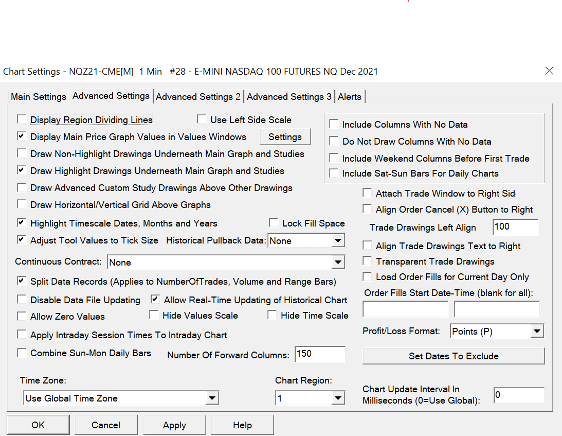

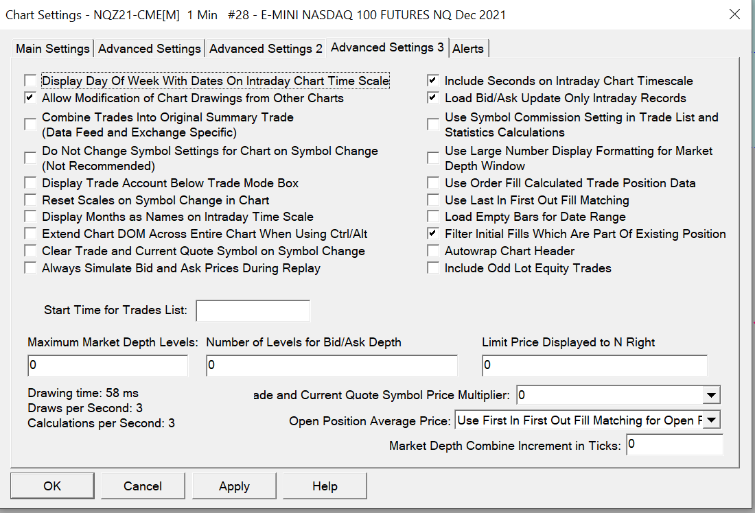

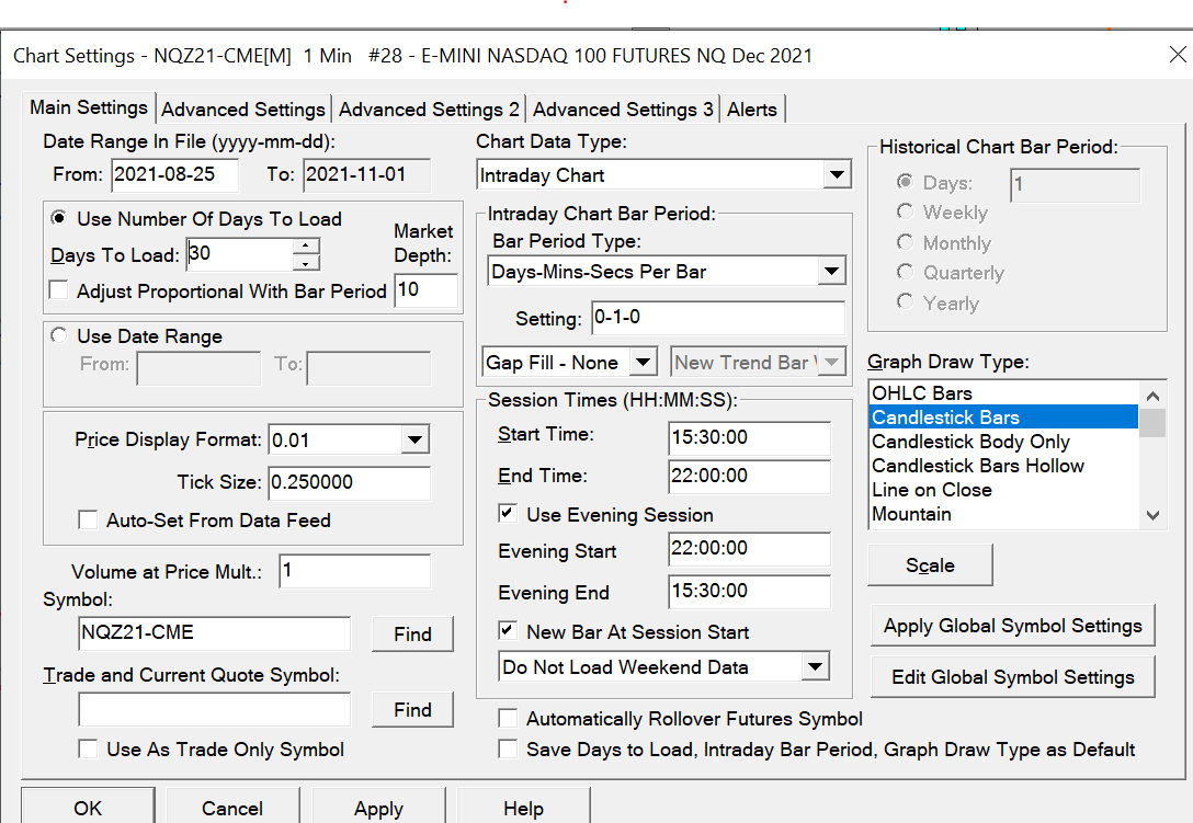

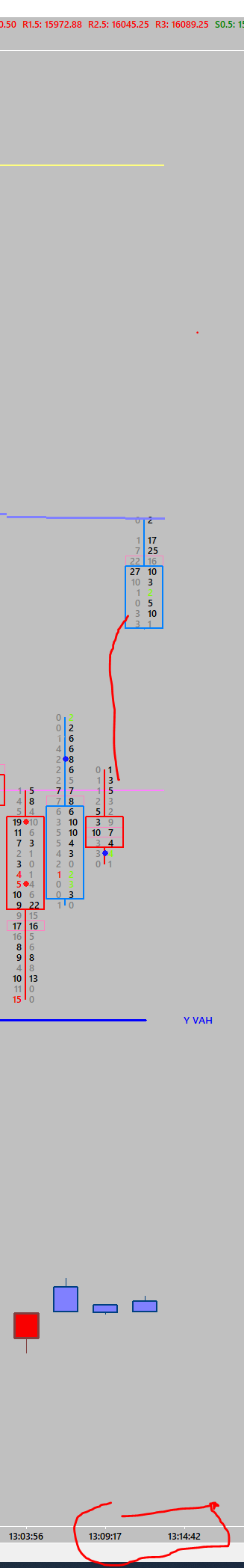

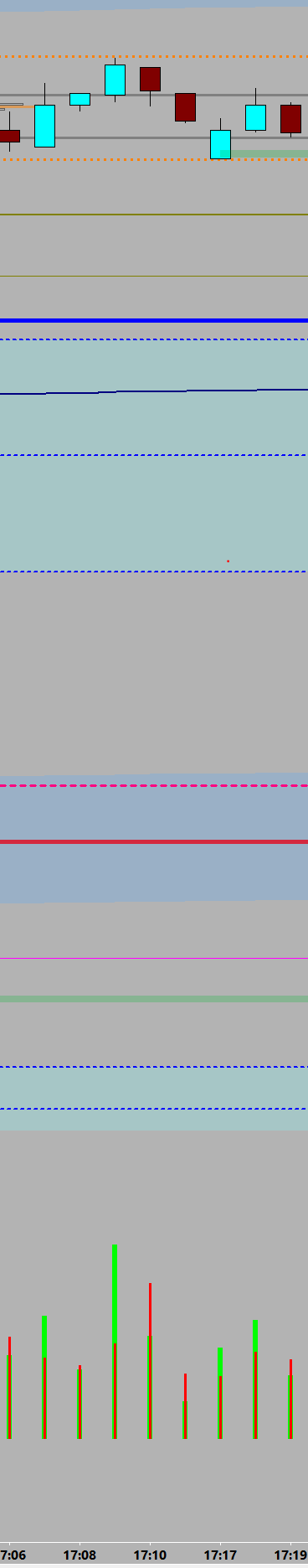

Thank-you for your prompt response. This does not solve the problem. My problem is on the candle / footprint charts. Sierra only loads the history where the app was on. If, for example, I close Sierra at 8 a.m. and reopen at 9 a.m., I wouldn't have the candles from 8 to 9 a.m.
On capture 2, I closed Sierra at 5:11 p.m. and reopened at 5:17 p.m. I don't have candles between these two hour
imageCapt sierra.PNG / V - Attached On 2021-11-01 16:23:13 UTC - Size: 72.27 KB - 316 views
imageCapt 2.PNG / V - Attached On 2021-11-01 16:25:08 UTC - Size: 12.33 KB - 343 views
[2021-11-01 16:32:17]
User440207 - Posts: 8
File attached
imageAdvanced set 1.PNG / V - Attached On 2021-11-01 16:31:58 UTC - Size: 71.77 KB - 268 views
imageAdvanced set 3.PNG / V - Attached On 2021-11-01 16:32:10 UTC - Size: 65.74 KB - 255 views

[2021-11-01 21:06:55]
Sierra_Chart Engineering - Posts: 25390
Are you still noticing any issue when using Safe Mode?
This log does not give us an indication of any problem. It does not show a historical Intraday data download.

[2021-11-02 12:17:03]
Everything works fine when sierra is open.
I did a test again, same problem
imageCapt3.PNG / V - Attached On 2021-11-02 12:16:59 UTC - Size: 27.92 KB - 309 views
