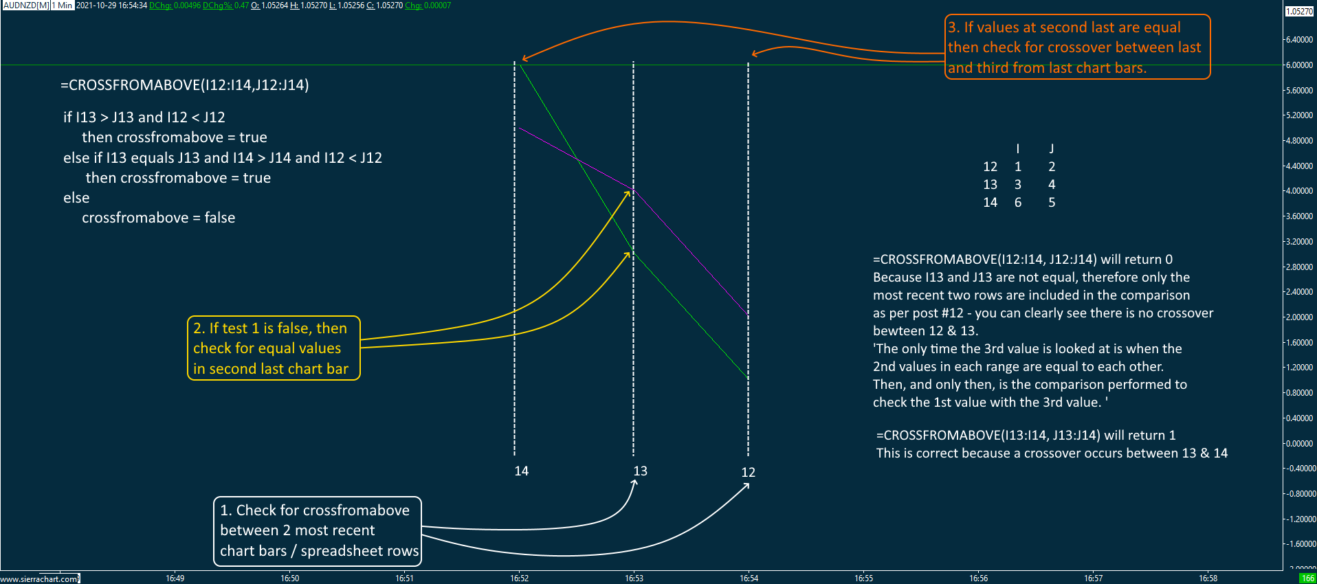

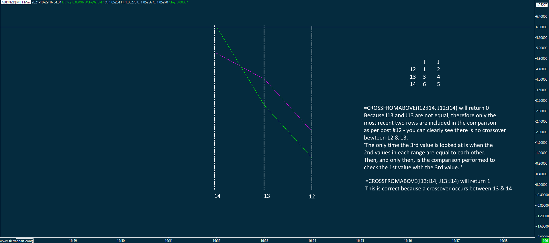

User431178 - Posts: 907
All the information to answer your query on the first page of this thread.....
See attached image for explanation, nothing is broken you are misunderstanding how it works.
imagecrossover.png / V - Attached On 2021-11-28 18:10:09 UTC - Size: 111.35 KB - 478 views

[2021-11-29 08:12:31]
Maybe my wording could've been better, so I'll try again.
Comparison starts with the two most recent (rightmost) bars (or lowest numbered spreadsheet rows if you prefer), only under certain circumstances is the third (moving from right to left) bar included in the comparison.
1. You are mixing up two separate things, data is read in chronological order, 14, 13, 12 (12 being the most recent). That doesn't mean that the comparison for crossover starts from row 14. Nor does starting the comparison at the most recent bars mean that the data is compared from there backwards.
2. Look at the picture, the crossover occurs between the two most recent columns, so I don't see any contradiction.
3. No, that is not correct, see item 1.
Maybe the attached image helps?
imagecrossover_1.png / V - Attached On 2021-11-29 08:12:08 UTC - Size: 220.22 KB - 323 views

[2021-11-30 08:40:31]
1. You are getting too caught up in details that don't matter - the logic operations are the same.
2. Not really no, the third value is only there for instances when the crossover occurs on the second last value. Without the third value you would not catch crossovers that occur on the second last value, as you would only ever check between the last and second last values.
Yes, they cross, but not in the context of the function, which is looking at the most recent data for a crossover - the crossover in the first image would be indicated 1 bar earlier, as that is when the crossover occurs with the most recent data.
3. Because for crossfrombelow all you are doing is reversing the comparisons..... The third value performs the same function as with crossfromabove - deals with cases where the cross occurs on the second last bar.
Anyway I give up now because we are going around in circles.
