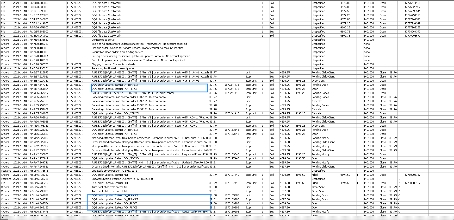

[2021-11-23 16:27:52]
Joperman - Posts: 20
Looks like it was CQG?
imageScreenshot at Nov 23 17-26-30.png / V - Attached On 2021-11-23 16:27:45 UTC - Size: 167.9 KB - 297 views
[2021-11-23 16:33:47]
Those orders you have highlighted were submitted by you in chart #9.
Date Time Of Last Edit: 2021-11-23 16:34:53

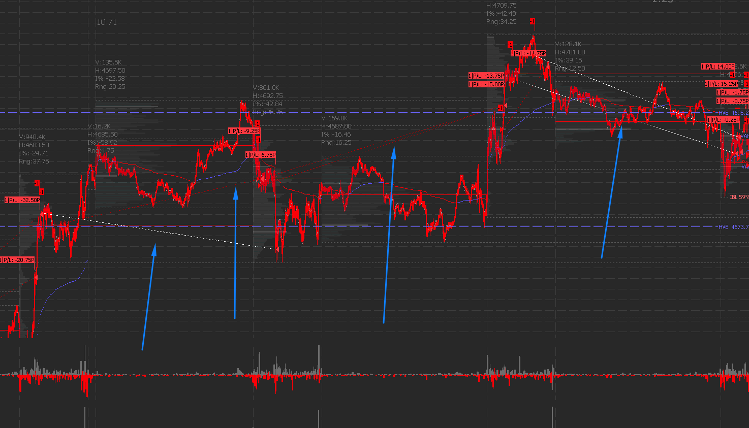

[2021-11-23 16:55:53]
There are some operations that I did not do anyway, it seems that some that if I did do not close, they are all operations in real mode, luck is that the broker does not count them as triggered! Could you help me locate the fault? I cannot cancel those operations that I did not do, and I need to add the operations that I did to my excel
