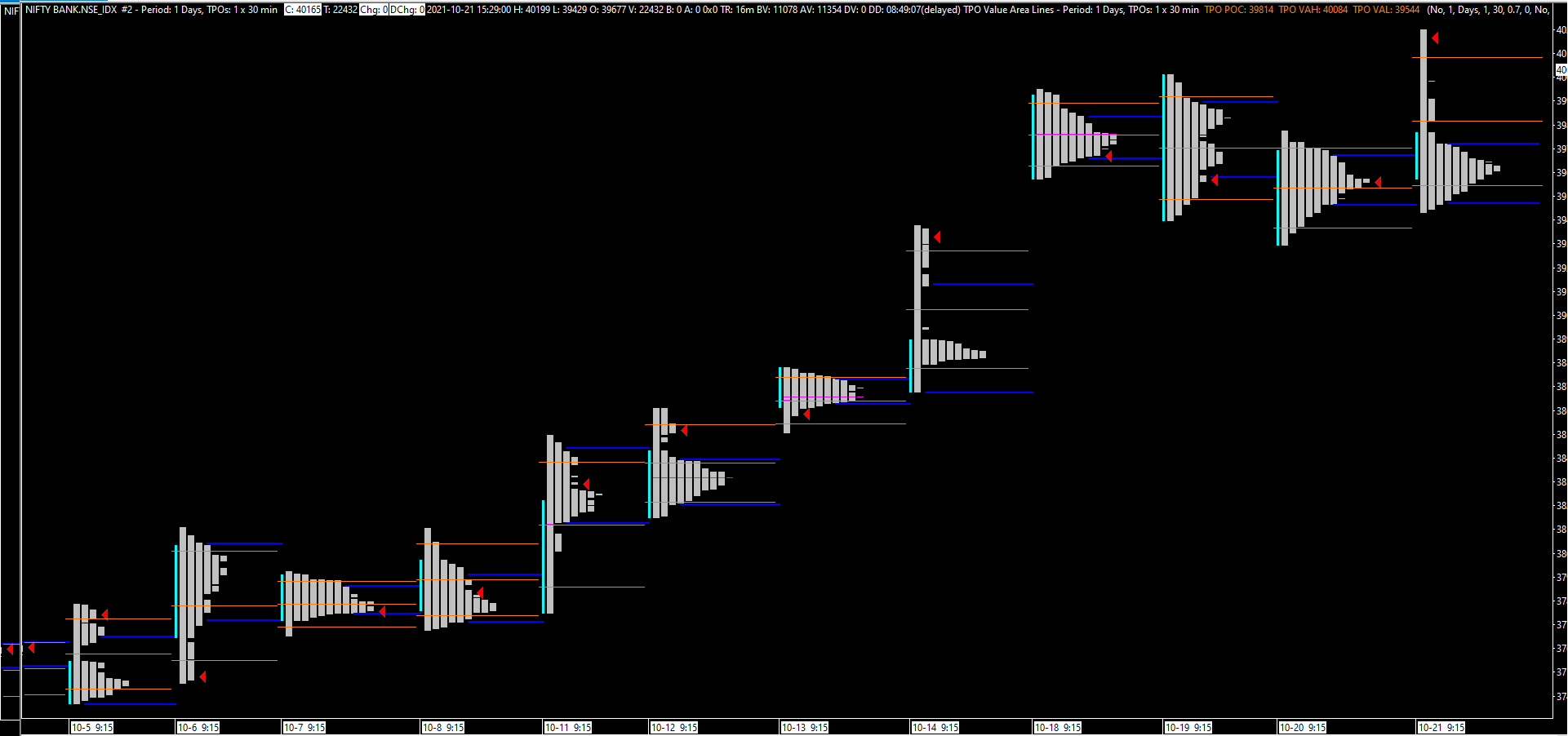

The two indicators are supposed to have the same value area calculations, but I get two totally different values for each indicator. What's the reason for this?
TPO Value Area line
Profile chart
imagevalue.png / V - Attached On 2021-10-21 22:22:47 UTC - Size: 36.04 KB - 315 views

Both are set at 70% in the settings.
[2021-10-21 22:54:13]
You can NOT set the TPO Value Area Lines on a TPO chart. As you found out, it does not work. Refer to the information at the following link:
Time Price Opportunity (TPO) Profile Charts: Using Other Studies on a TPO Chart
The purpose of the standalone TPO Value Area Lines is to display those lines on a non-TPO chart. Do this and compare the values and as long as the Value Area is the same, you will get the same results.
