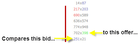

Is this possible to do with Sierra?
"The new Volume Imbalance uses a variation and compares the bid traded volume of one price to the ask traded volume of the price located directly above. It then employs an algorithm built into the Footprint that compares the ratio of volume between the two."
Link to full explanation: http://www.marketdelta.com/blog/2013/07/footprint-chart/new-footprint-type-delta-imbalance/
Thx
imagedelta-imbalance-compare.png / V - Attached On 2014-03-28 12:19:46 UTC - Size: 11.21 KB - 1011 views

[2014-03-30 03:25:42]
We have reviewed the Market Delta documentation.
This capability is fully supported in Sierra Chart and is known as a Numbers Bars Diagonal Dominant Side coloring. "Diagonal" will be the new term to describe it since it is a very intuitive way to understand rather than the term "auction".
Here are the step-by-step instructions to use this feature:
https://www.sierrachart.com/index.php?l=doc/doc_NumbersBars.php#DiagonalComparison
The documentation refers to version 1114 terminology. Update Sierra Chart by selecting Help >> Download Prerelease.
Date Time Of Last Edit: 2014-03-30 03:53:53
[2014-03-30 03:53:41]
The link we gave in the prior post was not correct. Here is the correct link:

[2014-04-13 16:47:03]
cmet - Posts: 743
For the volume imbalance, is it possible to specify the thresholds?
For example:
In the study settings and inputs you can specify:
0-25%
26-50%
...etc
Is it possible to change these percentages?
In Market Delta for instance, you can specify what percentage difference to use before the coloring is triggered.
Say...300% more on one side.
[2014-04-13 19:49:10]
Zosimus - Posts: 345
Yes Sierra Chart can do this.
It's a bit complicated to explain textually so I created a short video (Excuse my English).
Here is the link to the video : http://screencast.com/t/ayO2QDzRy
Good luck.
[2014-04-13 20:17:57]
cmet - Posts: 743
Thanks. That was nice of you to put that together.
[2014-04-13 21:14:31]
We assume that by "volume imbalance" you are referring to diagonal comparisons. You can do comparisons which are 100% and greater with dominant side and diagonal dominant side comparisons.
The percentages are all configurable. This is explained in the documentation here:
